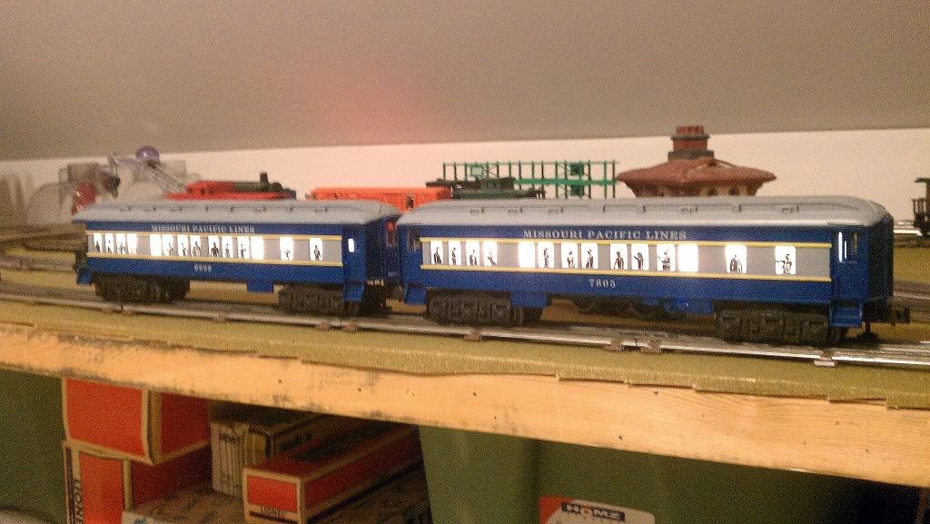

Thanks Rob! The bulb’s/roof lining had gotten out of place, got everything readjusted properly, ive never seen them this bright. Need to get the baggage taken apart later, a bit more difficult with the small windows.
http://i46.photobucket.com/albums/f128/Trainkid91/IMAG0647.jpg
