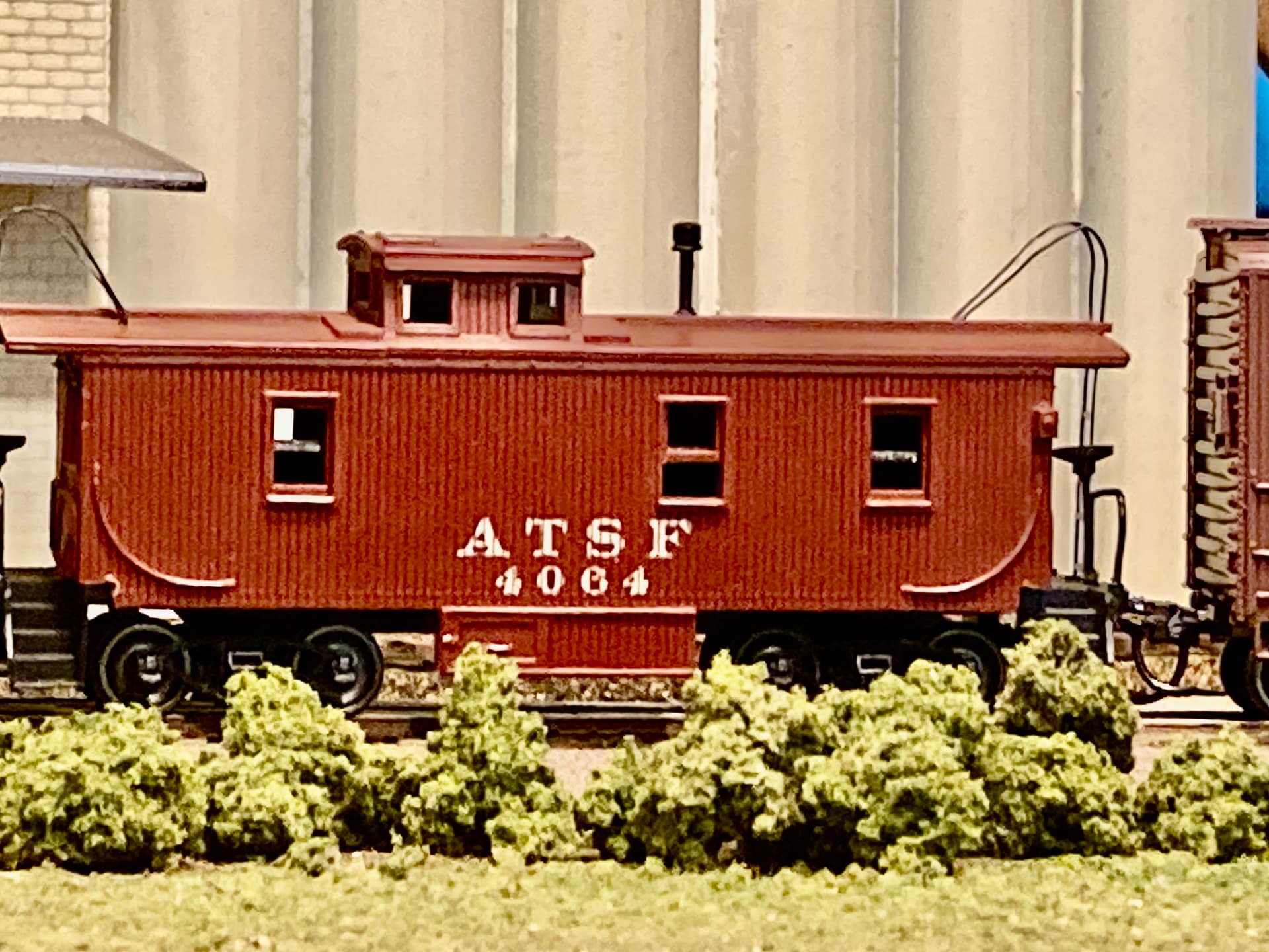

I am very partial to those Union Pacific wood cabooses. The first HO trains I ever saw were Revell train sets back in the late 1950s, and this caboose was in a lot of those sets. To me, they looked a whole lot like the SP cabooses we saw across from the depot back home all the time and I had to have one.
This is the first car I ever got beyond my HO train set. It looked so much like the SP caboose I was beside myself. The fact that it was lettered for the Santa Fe didn’t matter to me at all. A couple of years ago I bought this one for sentimentality sake and restored to operate on my layout.

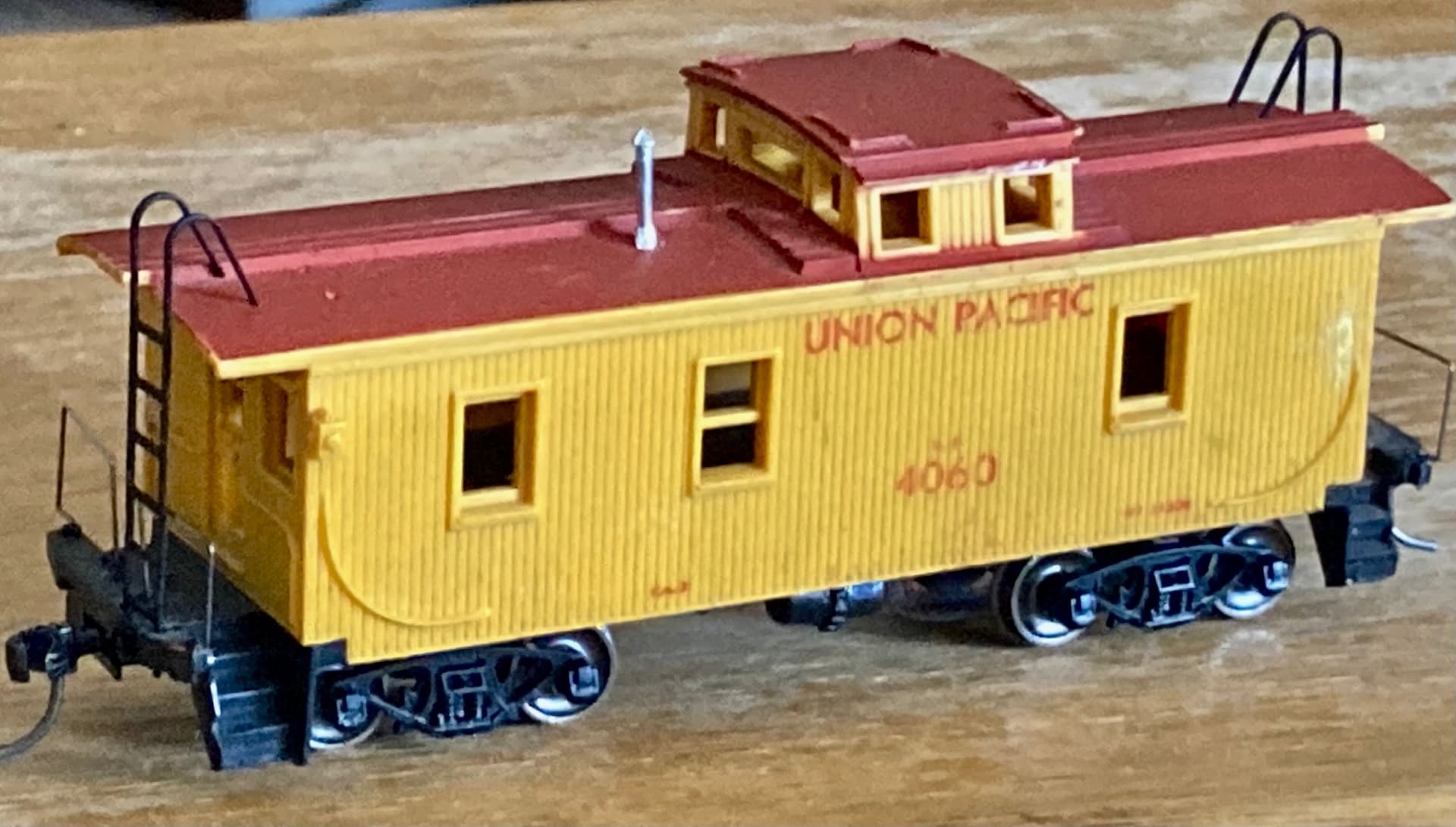

A little bit later, I felt like my life wasn’t complete unless I got the Union Pacific car too. I got a beat up Shell for two dollars and restored it also to operate on my layout.
