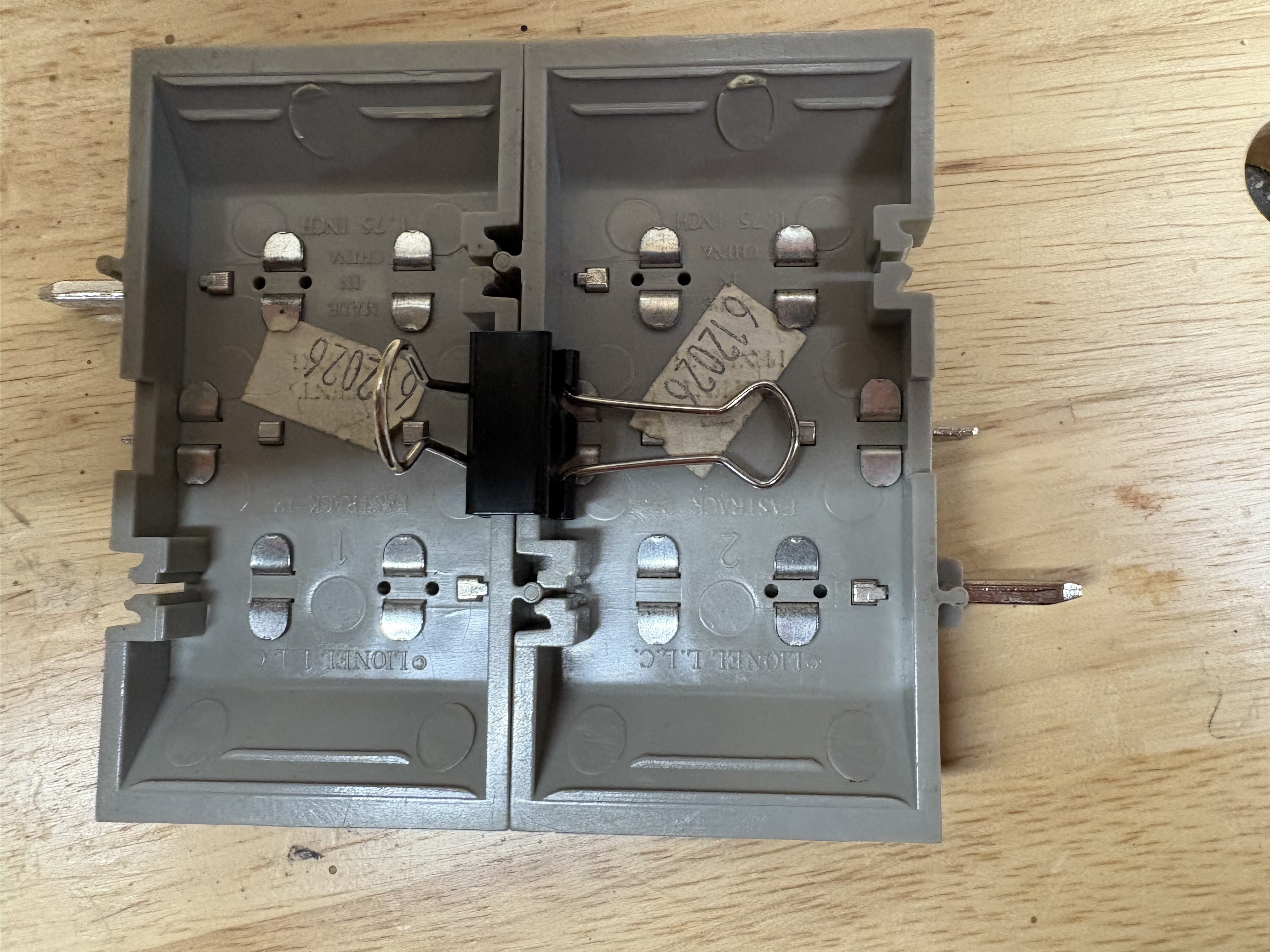

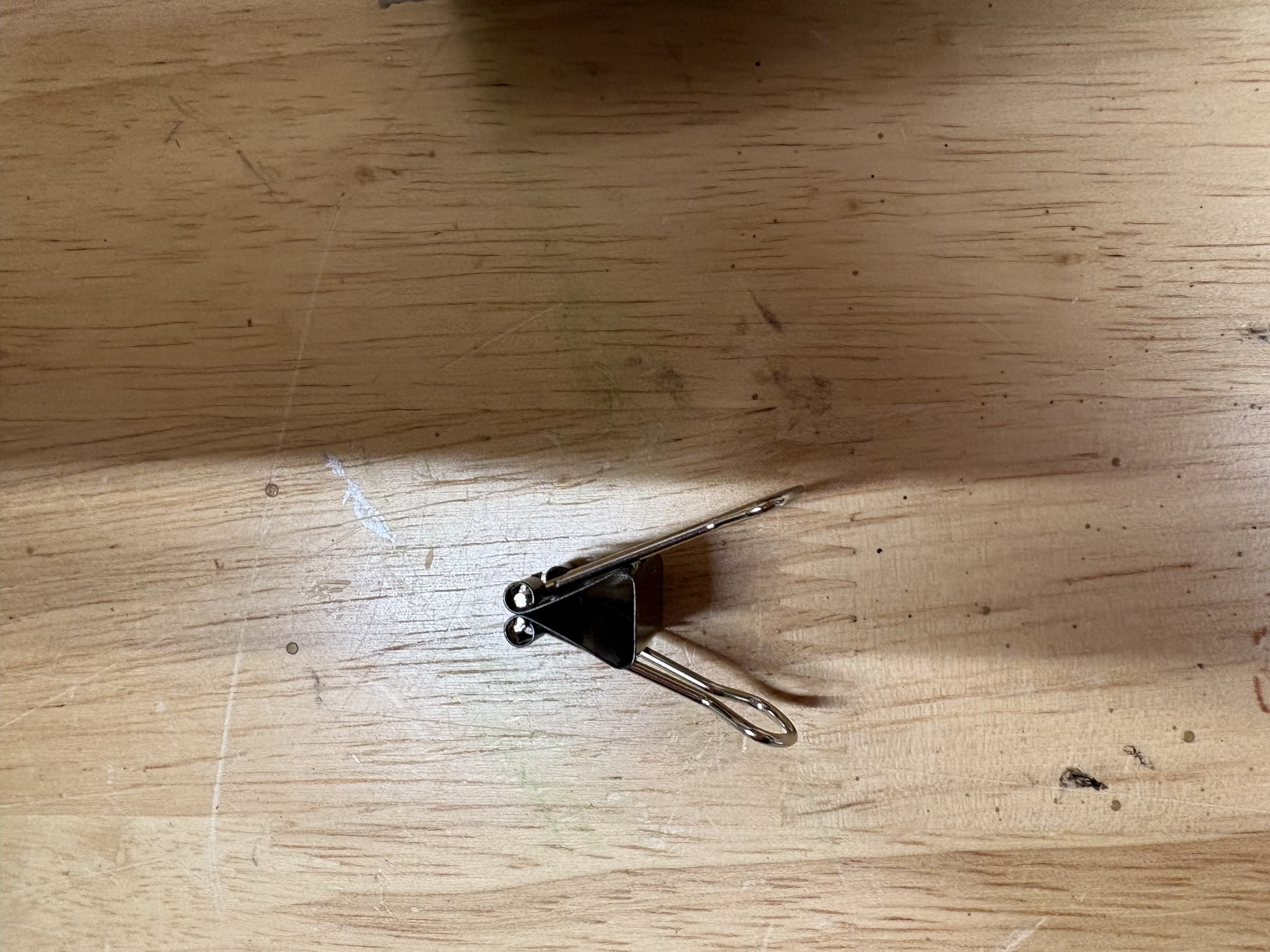

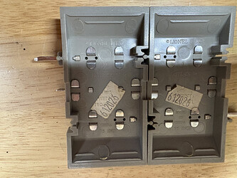

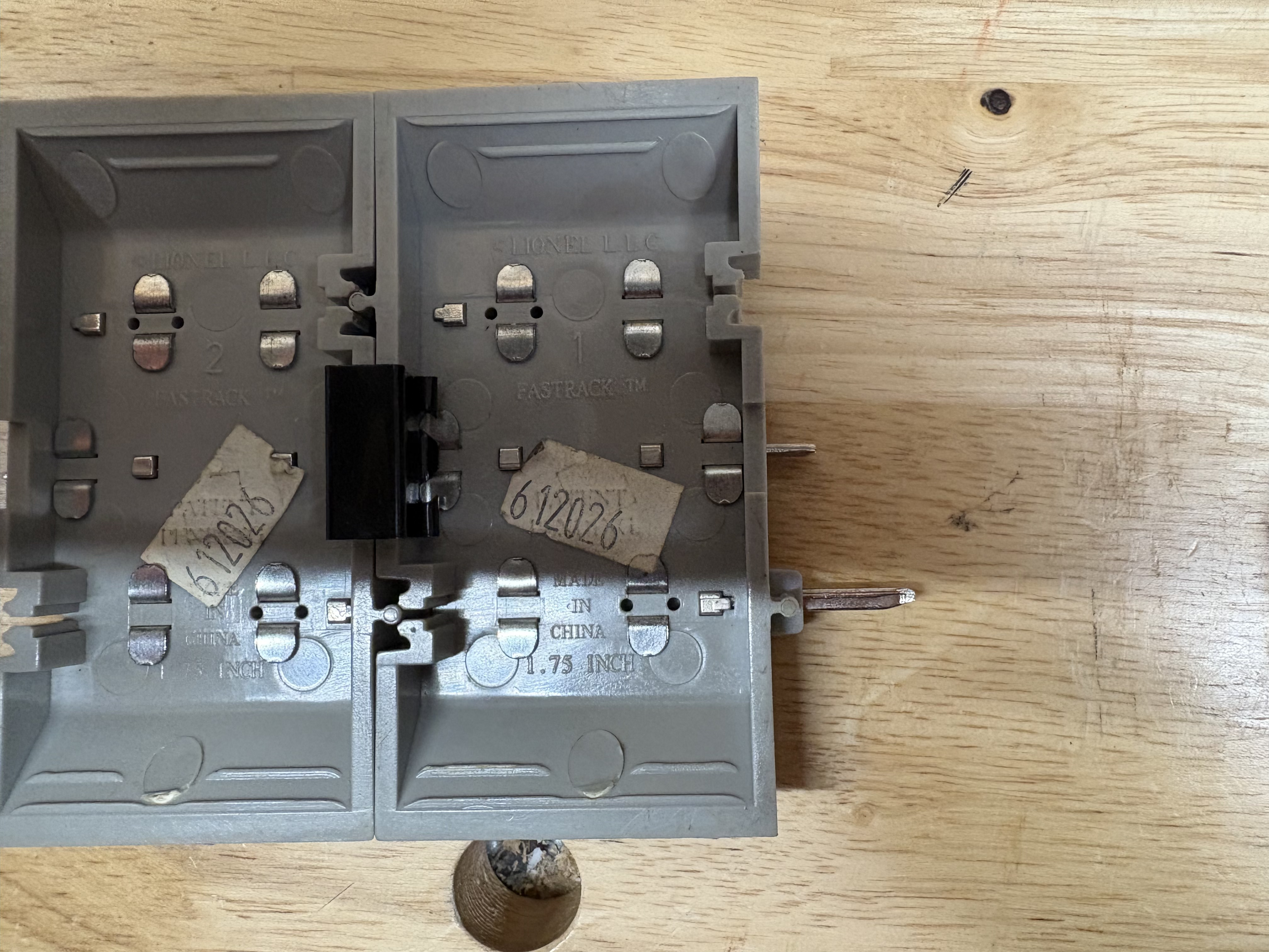

I have changed my Fastrack layout so many times over the years a lot of the tabs have broken. I use binder clips to hold the track together. I do not fasten the track down. It sits on top of indoor/outdoor carpet.
