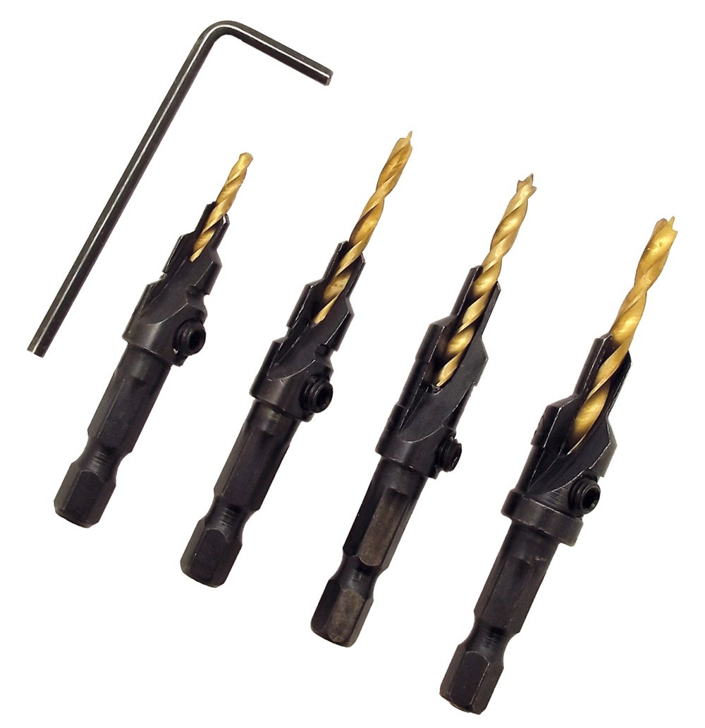

Just get yourself a set of these and don’t worry about. They are sized for the screw #.
In my limited experience, both are correct. I have one of the bits shown in Carl’s post just above, and used it extensively on my second layout that had MDF spline roadbed. I pre-drilled the retainer screws driven down into the middle of the top surface of the roadbed and through into the risers with one of those, and it worked well. On my latest build, I pre-drilled pilot holes in all the spruce 1X2 and 1X4 bench members where I joined two pieces together, but I only used a 3/32" small bit in a drill, somewhat thinner than the shanks of the 1.25" long wood screws. No splits either way.

And the combo bits Carl showed are I big time saver.

However, I’ll second Carl’s suggestion to get the bits with the counter sinks built in. The drill bits are replaceable if you break one and you can adjust the depth of the hole.
They can be purchased individually if you don’t think you will need the whole set.

The all in one’s are a great resource. generally, they’re made for drilling holes in wood for wood screws and work well for that.

I have done lots of deck construction and have used a pilot bit similar to the one’s Carl pictured. The bit does not need to go to the bottom of the screw when inserted but rather start the whole and cut the cone for the head of the screw. Some of the really cheap counter sink combo’s are so poorly made that they are eccentric and do not do a good job of center boring. I have had good luck with DeWalt countersink sets but not some of the big box store brands made in that big Asian country.
The countersinks that carl shows work and set pilot hole/ counter sink fine for your use. The “flip bit” that has been offered by dewalt, Stanley makita and copied by many others is what I have used proffessionally for over 20 years since thier introduction (what a pain, years ago w/ 2 VSR plug in drills set up w/ the bits needed- cords and more cords and spaggetti). The Quick change kits have made finding them harder lately. But they are still stocked or can be ordered. wnen dealing w/ such softer materials like pine and fir or pine plywood, it is not as critical to select an exact bit. I deal w/ hardwoods (maple, ash, oak) and the pilot, clearance (bit) and proper countersink is immperitive to be more exact in cabinet construction and intallation
This flip bit has the proper sized pilot/ countesink as well as the built in allen to change depth setting of bit. Shown is the #8. Sets are #6,8, and #10 (some w/#12)

Thank you for the replies. The chart was just what I was looking for. I did follow the suggestions and stopped at my local big box store to look at their offerings. The guy working the tool department said they don’t carry anything like that but I took a look anyway. Sure enough the Dewalt quick change set was there. The only problem I see with it is that the drill bits have a flat spot on the base for the set screw. My spare drill bits don’t have the flat spot so they might not work if I need to put a longer bit in.
