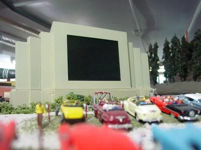

DRIVE - IN WITH "WORKING" LCD SCREEN FOR HO LAY OUT
A FEW YEARS BACK I SEEN A ADD SELLING A DRIVE IN SET UP FOR HO THAT HAD A WORKING LCD SCREEN! NOW THAT I WANT TO GET ONE - I CANT FIND IT FOR SALE ANYWHERE!!! HAS ANYBODY EVER SEEN THIS ADD BEFORE??? AND DO THEY STILL SELL THEM OR IS A DREAM I HAD ??? [:D]

I believe that kit was produced by Miller Engineering, the guys that have all the EL signs. Besides the LCD TV it used as the screen, it had chase lights and ‘neon’ (actually some of their EL sheets) signs. It was pretty cool actually, but expensive because of the LCD TV. Price on consumer electronics like that have come down a lot since that kit was introduced, it shoul dbe possible to duplicate it for less than the original one cost.

I think your best bet would be to buy a cheap portable DVD player. You could mount the “player” part under the layout (you may need to do some advanced soldering depending on the cable lengths, certainly you’ll need to detach the screen and remove the surround in order to fit a new “scale” one). Better still might be one of those kits to add screens to a car (the type beloved of MTV that fit on the back of the front seat headrests) - the screens are already detached and would be less hassle to de-case and fit into a layout. Hope these ideas are of use!

I like the idea of the projection, and actually this really wouldn’t be that difficult to achieve. The idea of the projector was right on the money. Maybe this is a little beyond what a lot of people would want to do, but there’s no such thing as an LCD that gives off light. They’re all lit from behind somehow. I have LCD projectors and get the basic idea. If a person were to tear apart a cheap old digital camera for the LCD viewer on the back you’d have a nifty little screen that can be adapted to your needs. Use a few white led’s behind it and build a little box, try some different el-cheapo flashlight lenses for focusing, and use a mirror if you don’t want to try to fit the whole thing in your projector building. You’ll be more prototypical by projecting from the projector building, and then you can have a drive-in screen that’s to scale and doesn’t look too bulky, and you really WILL have to turn the lights off in order to make the thing work.

The Elmhurst (IL) Model Railroad Club http://www.emrrc.org/default.htm has a working drive-in on their layout. The only picture I could find of it was on their website. I’m not actually sure how they did it, its been awhile since I actually saw it in person but I believe its an old laptop underneath the layout with the screen sticking up through.

I was at a show last year and saw one. It did not look bad at all, and they even has sound to the movie they were watching. The cable can go under the layout and the LCD screens are very thin now. The only problem I saw was the movie they were playing was not the same as the time of the layout. I do not think it will be hard to create using the inexpinsive LCD you can find at Walmart. You can use cheep speakers under the layoyut and it should look good! I might even try it on my layout.
