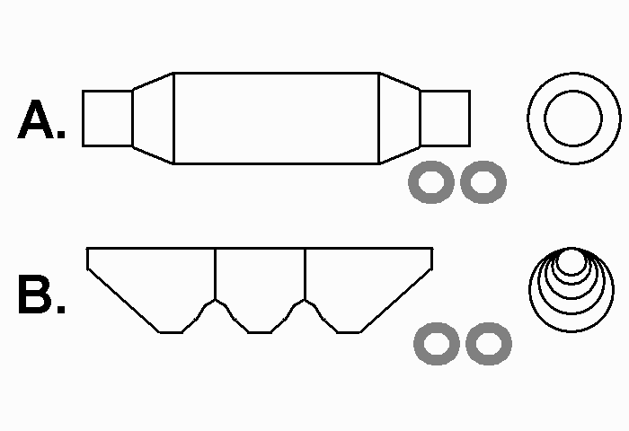

I’ve seen two main types of Heil bulk trailers, with the side and end profiles shown in the drawing below: Cylindrical (type A) and round hopper (type B). My question: Is the type ‘A’ trailer vessel ever used to haul dry concrete? Or is only type ‘B’ used? If I can be prototypically correct using type ‘A’, that will be ten times easier to scratchbuild than the type ‘B’ body.

Check out Kalmbach’s Industries Along the Tracks I do believe the 3rd in the series. Has a chapter all about cement and concrete. Has a photo from what I gather to be 80’s to mid 90’s showing an old Mack R (with a sleeper!) attached to your type A trailer being loaded with cement.
Looking at your little drawings I don’t think it would be hard to build the A type. I live by a rail-to-truck cement facility so I see so many 3-hopper pneumatic trailers I don’t even notice them that much. I do a little more now because there are A LOT of construction projects going on in the area using concrete so their business in the last 3 or 4 months has gone up probably 400%. There is never less than 10 3200 cube “cement hoppers” waiting there. Their 3 spur tracks can only hold about 15 total. A neat little facility though.

All of the ones I’ve seen for many years are your type B or similar where there are some type of chutes to unload.

There’s a large Portland cement plant in Marana, Arizona along Interstate 10 just west of Tucson, and a very large fleet of 100 or so trucks to deliver dry cement throughout the area (marked CTI). All their trailers are type B.
