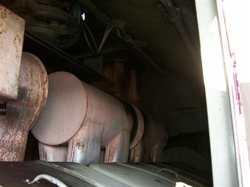

It is possible to cram in a 4-stack exhaust with dynamics. This is on a GP38AC.
