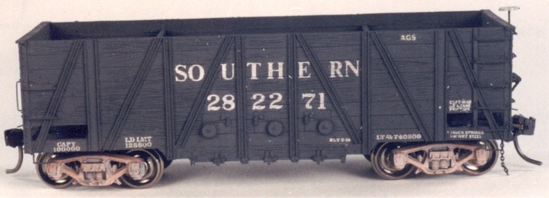

In looking through the 200 or so N&W hopper images that I have digitized, it looks like you’re in luck: the N&W had a LOT of Seley hoppers, which were all-wood construction. These ran through WWII at least. Best of all, Funaro & Carmelengo has had a model of these cars available for YEARS:
While not an exact match, it’s as good as you’re going to get without scratchbuilding.
All wood.
Hmmmm.
What type of wood were they using for the channels and underframe? Ironwood? :sunglasses:
But seriously this is one of those inbetween cars from the WW1 to 1940’s that was a transition between wood car and steel car, having steel underframe and structural parts and wood sides. Note also that the N&W has arch bar trucks, and is restricted (by the time of the photograph) to on line cinder service. Also note the yard tracks don’t have tie plates! The 1905 ORER doesn’t show any cars in that series in service, it actually doesn’t show any hopper cars at all, only drop bottom gondolas and hopper bottom gondolas.
