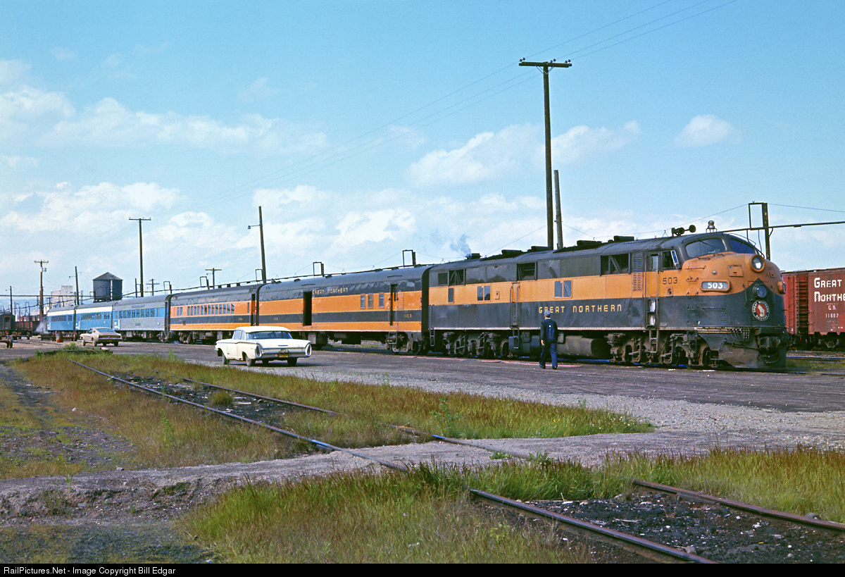

Above is the single E7A that pulled the Portland section of the Empire Builder from roughly 1948 to 1953.
The famous Train of Tomorrow was pulled by one E7A:
Here’s the Wabash Bluebird:
GN trains from different “eras”:
If a single unit could do the job, a second one was usually not added.
Ed

I rode the GN “Badger” from Minneapolis to Superior WI about the time that picture was taken, the train like that one just had the one E7.
Early streamlined trains were often fairly short, 4-6 cars, and often used just one E unit. As trains got longer, the railroad often added a second or third diesel, but it still wasn’t uncommon to see a train with one E-unit provided there were no steep grades. Sometimes (as with GN’s Gopher / Badger), a second diesel would be added in the depth of winter just to help provide enough steam to heat the cars.
