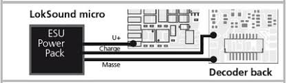

I purchased an ESU Powerpack to supplement my micro, too big unfortunately for the installation loco. The Powerpack has 3 wires, ground (black), a red (+) and a white (charge) I have a TSU “Keep Alive” that will fit, but since only two wires are involved with the TSU, which pads to solder to? The pads that the black (Ground) and white (Charge)?
ESU wiring diagram for the Power Pack
Edit-Disregard, found the wiring diagram for a two wire capacitor, its ground and U+
For anone else searching for the answer, diagram below

I swear I have it right, but I have a micro for one of my switches and I’m using the 2 wire NCE capacitors. I can’t get the loco to act right nor does it seem like the no halt unit is working?
Can one of you guys confirm or send a more clear picture as to where the two wire set up would get soldered on the mini board?

I hope to go after adding a keep alive to my micro tomorrow, I will take pics of what I did and let you know the result.
I agree, the schematic looks very little like the actual decoder, I was very hesitant, but I figured, since it is ther ONLY soldering pad on that side of the decoder, I didn’t have much choice.
I don’t have an issue soldering, I would just wish the schematic for doing it would be more clear. Better yet (ESU), just provide a plug like everyone else. [;)]

I failed in getting the power pack or a TSU KA 3 to work with the Micro. The wiring diagram looks nothing like the decoder I have, and I decided to throw in the towel as experimenting with electronics always turns out badly. For now my eyes hurt from staring a soldering pads. [B)]
Mike
I received these pics from ESU, thanks tech support!
http://gearedsteam.blogspot.com/2016/10/soldering-esu-powerpack-to-esu-loksound.html
