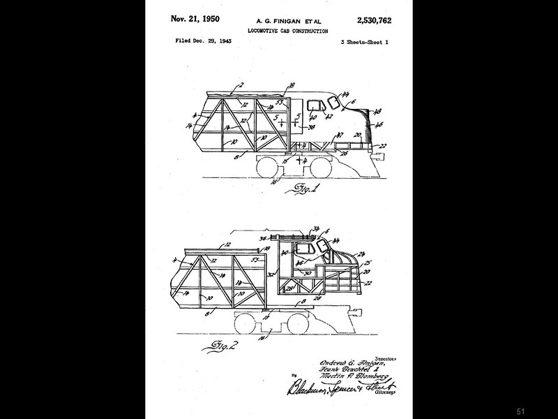

The Iconic shape of the F series et al locomotives, who designed that form, how was it made, did EMD have a “trademark” with it… Does anyone have fabrication drawings of it??

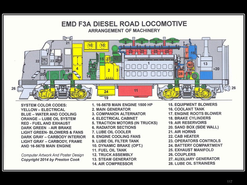

Here’s a good place to begin. Just some background: (Click the image to be taken to the album of photos) The Barriger Library has made public thousands of images and documents. Bravo!
Slide60 by John W. Barriger III National Railroad Library, on Flickr
Slide117 by John W. Barriger III National Railroad Library, on Flickr
Slide51 by John W. Barriger III National Railroad Library, on Flickr

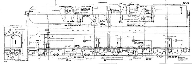

EMD-FT-PLATE3756-DIMENSIONS-ABBA-COUPLERS-NODB-NOSG-MOPAC-505-TO-506-02 by John W. Barriger III National Railroad Library, on Flickr

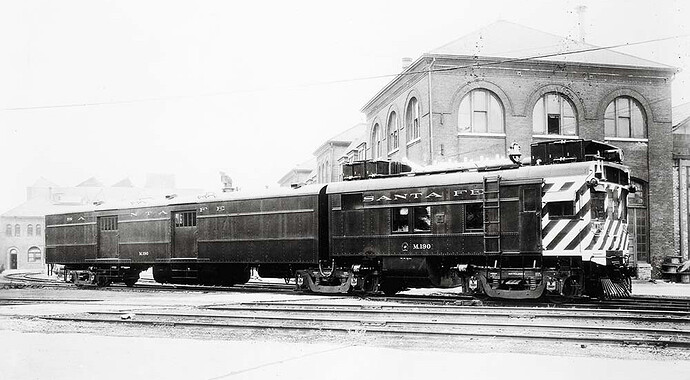

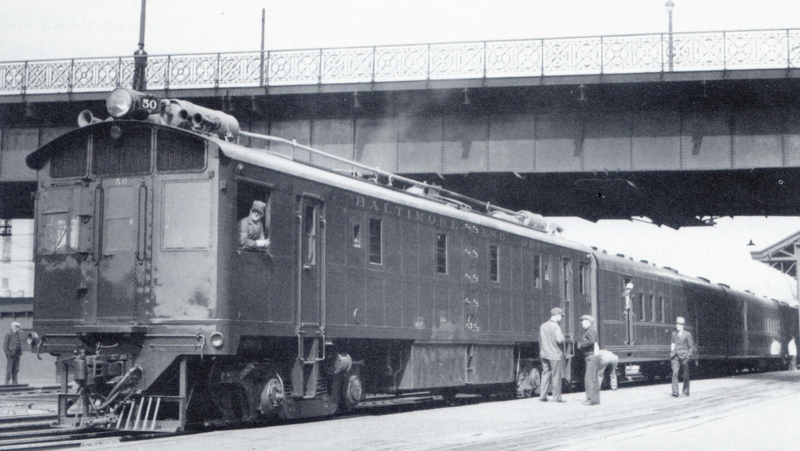

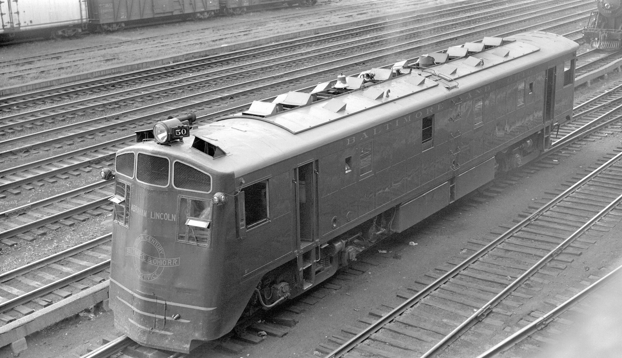

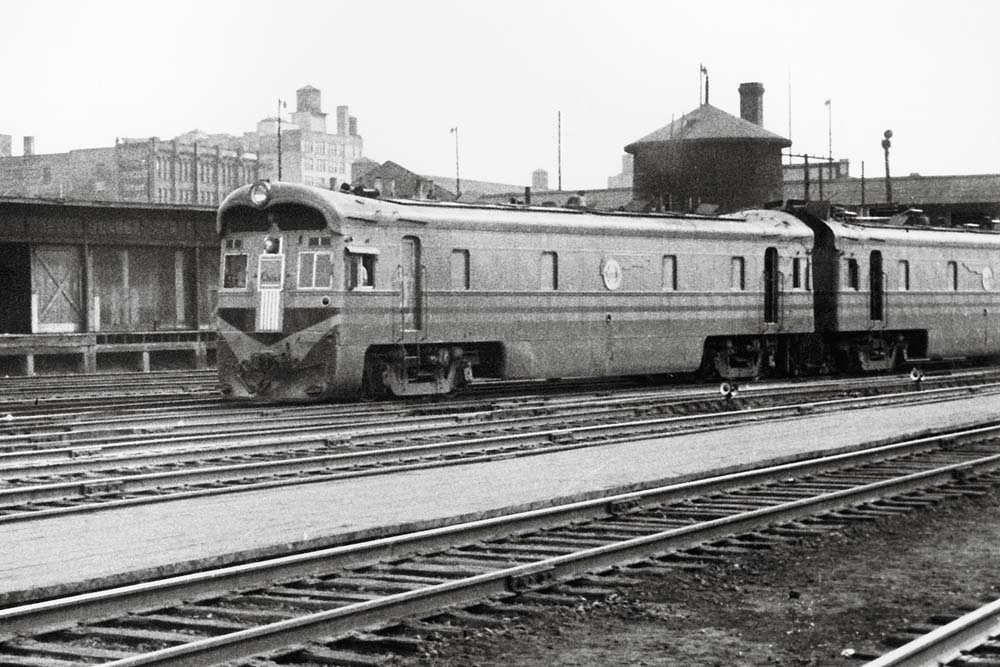

Box Cab locomotives were difficult to ‘streamline’
as delivered
As ‘streamlined’
That thing looks like it was built to construct tunnels by ramming it at high speed against solid granite :hushed_face:
