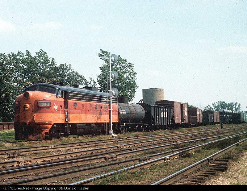

Then, on a whim, I checked Google Images for photos of 108-A in service and found this nice shot, taken (where else?) at Rondout, Illinois–one of the exact spots my grandfather used to take me to watch trains. Pretty cool.
