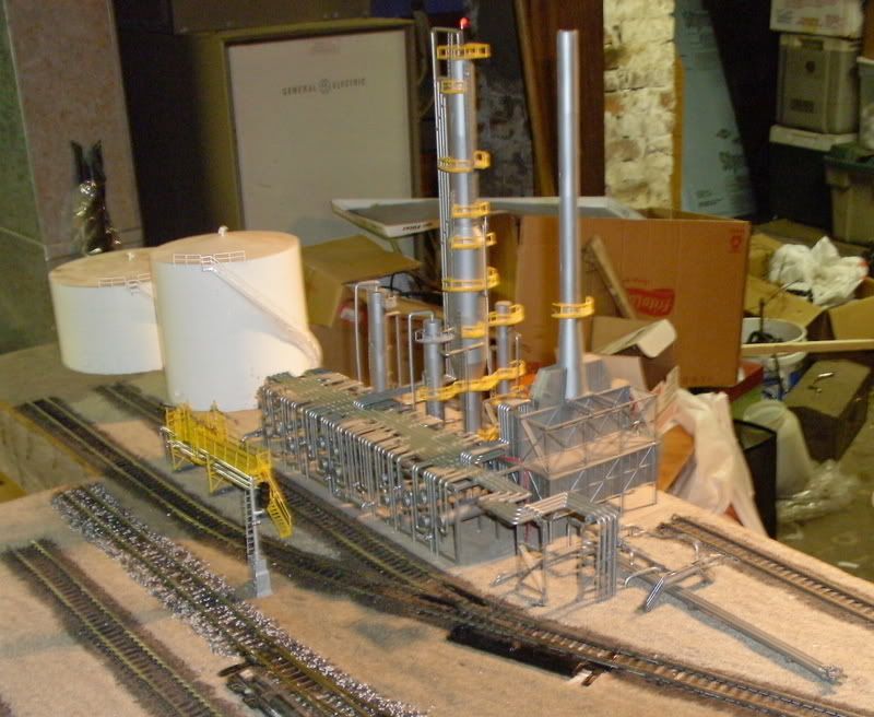

Last year I built a Walthers 500,000 gal fuel tank for our club layout; it had a curved stairs that possibly could be replicated using a Central Valley #1602 Steps & Ladders Set
http://www.walthers.com/exec/productinfo/210-1602
IN the picture, the steps on the upper left could be used. You will have to clip / trim every riser on one side so the steps will curve. You may have to heat the steps in warm water to get them to bend without breaking (the plastic used the Walthers steps were very flexible).

The caged ladders should work well on smaller cylindrical tanks. I wonder if the fire escape stairways could be “notched” to curve sideways up the side of a larger tank. Think I’ll order a couple sets of each to experiment with. Thanks, Pete.

They are a good quality product; I have used them a lot to make industrial platforms and stairways.
I forgot to mention that the inboard side of the stairs would have to be clipped off flush with the riser (the one that gets trimmed); the remaining bits of riser would be used as a gluing base onto the tank.
The Tichy Train Group Oil Tank has stairways with the steps connected only on one side which allows them to wrap around the tank. There are no pins on the stairs to insert into the tank, so you have to cement, or CA, them to the to the tank a few at a time and carefully secure them while the adhesive sets. It has been a few years since I assembled them, so I am not sure, but I think I used masking tape. If you cement them, use CA to fill the gaps between the steps (straight edge) and the curved tank.
