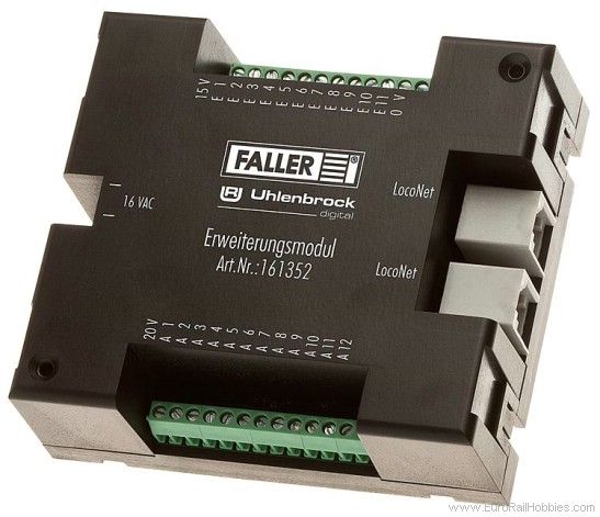

Does anybody out there know any HO scale model train modelers who integrated the Faller Car System into their layouts. Is there any other car system other than HO scale slot cars, that is similar to the Faller Car System? Are their any obsolete systems no longer being made? If adding traffic lights, stops (bus stops) etc you will need sensors and traffic light controllers connected to a PC module. The PC module can be connected to a DCC system if you have one via the RJ11 telephone plug Loconet serial bus network. You have two option; either the PC module if your DCC system is not connected to the PC and you want PC control, or the expansion module if you don’t need to control via PC.

If adding traffic lights, stops (bus stops) etc you will need sensors and traffic light controllers connected to a PC module. The PC module can be connected to a DCC system if you have one via the RJ11 telephone plug Loconet serial bus network. You have two option; either the PC module if your DCC system is not connected to the PC and you want PC control, or the expansion module if you don’t need to control via PC. Here’s an example of the Module and where you can buy one. http://www.eurorailhobbies.com/erh_list.asp?erh_find=expansion+module&x=0&y=0
