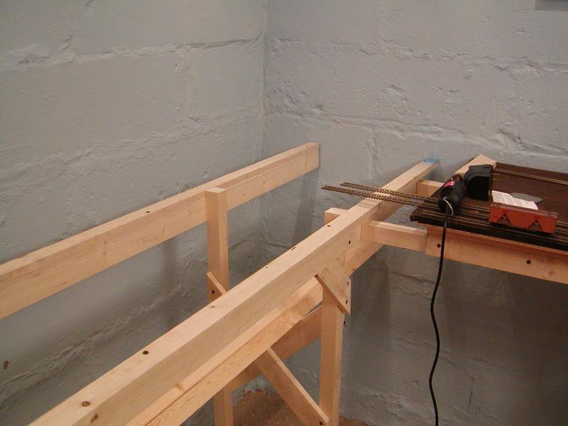

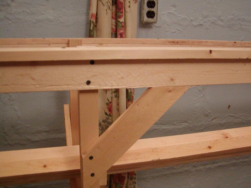

Here’s a couple of pics on how I put my together. I used drywall screws and drilled pilot holes. Hope this helps.
(click to enlarge)
I used 6X2 wood screws, all pilot drilled first, and only used carriage bolts to fasten the modules to each other…and boy is it solid! Only braces, no gussets.
EL, I ripped some 1X4 lengthwise, and used the two pieces, cut to the length of the legs I wanted, as small L-girders, too. So, in my case, I split the 12’ lengths, then cut the resulting two pieces into 47" lengths for my legs, but made them into L-girders. That way, they are very strong and will withstand lateral forces. However, as your question suggests, where they anchor to the frame corners, there isn’t much depth there, so not much strength. Two 2" screws at each corner, and then a diagonal brace of the same ripped 1X4 material, screwed with 2" screws where needed.
The pictures above are essentially it.
