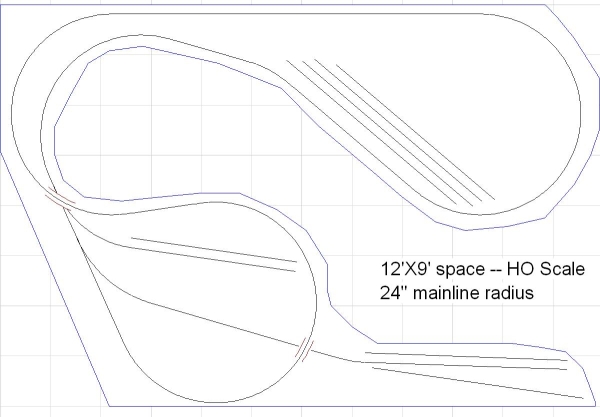

This probably won’t work with your space exactly, but it’s an example of what might be done in a similar space with 24" minimum radius on the main line. This very quick sketch has a couple of issues of its own (like the turnout under the bridge), but hopefully it will give you some ideas as to alternatives to explore.
I couldn’t tell from your drawing where the access was to the 12X9 space, this assumes it is from the right side of the sketch. If there is not also access from the bottom of the sketch, you need the access space at the lower left, otherwise you could be more flexible in this area.
Hope it helps a little. I would again strongly suggest the Armstrong book I recommended earlier.
