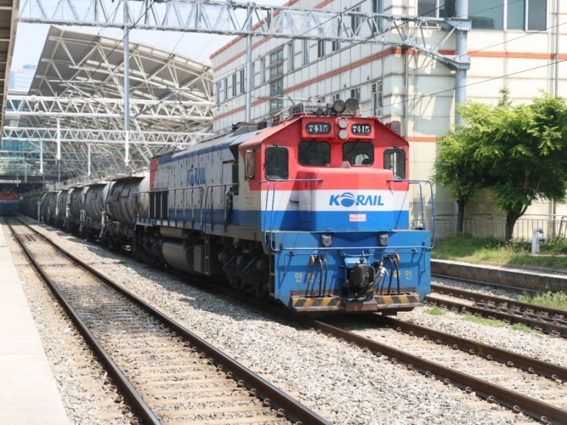

Mike, according to The Diesel Shop, the overall truck wheelbase is 11’11”. I’m not sure what the center axle spacing is, all I know for certain is that it’s off-center. https://www.thedieselshop.us/Data%20EMD%20GT26CW.HTML
Randy, this is the Frateschi locomotive in question:
This is the locomotive I’m building:
