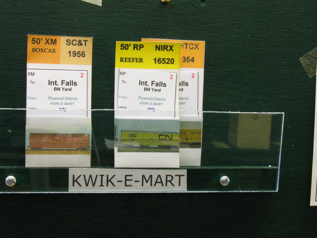

I’ve only one pocket.
This is my latest version. Between sessions I fllipp the waybills. So you have only to follow the instructions at the waybill.
I made the car cards & waybills with excel. Look at my operation site.
