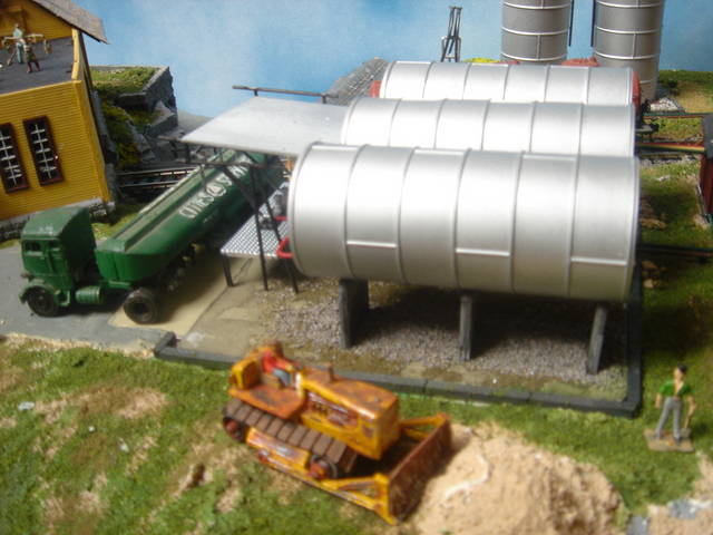

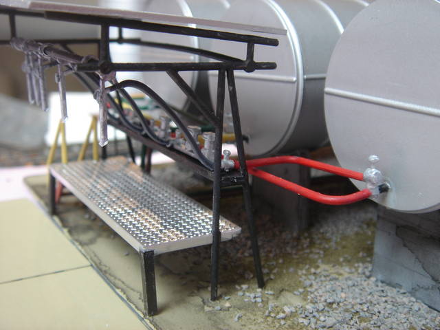

I chose to use the Walthers “Interstate Oil” kit. This is a tight shot of the plumbing used around the part of the facility where the tanks are unloaded into the fuel oil trucks.
The kit comes with 5 tanks, 3 horizontal and 2 vertical in the background. It’s also got an office with a quonset hut that I didn’t use here.
Just to the left of vertical tanks in the background you can see the fixture for unloading tank cars from the top. It has a rocker arm that hoses hang from. That’s part of the kit, too, along with a small shed for the pumping facility.
