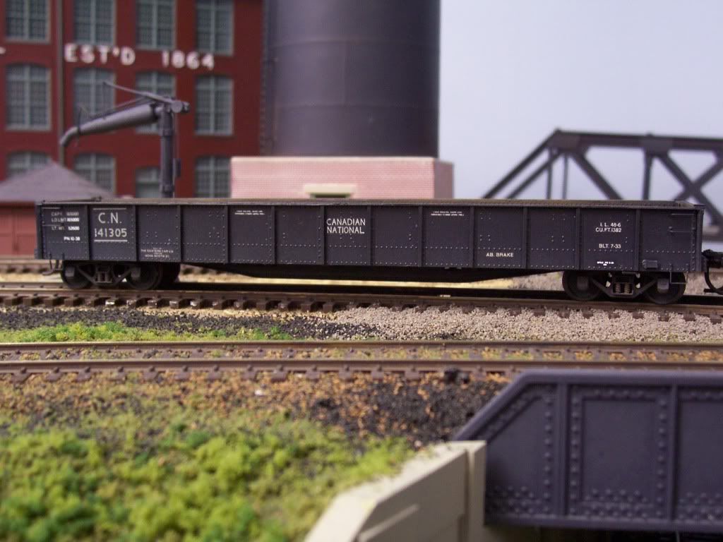

This Westerfield gondola came with no instructions and some smaller details missing, but as part of an estate lot, was only $4.00. I had photos of the prototype, so it wasn’t all that difficult to build:

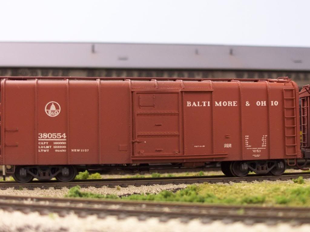

This one’s from F&C, and with the one-piece body, was easy to build:
