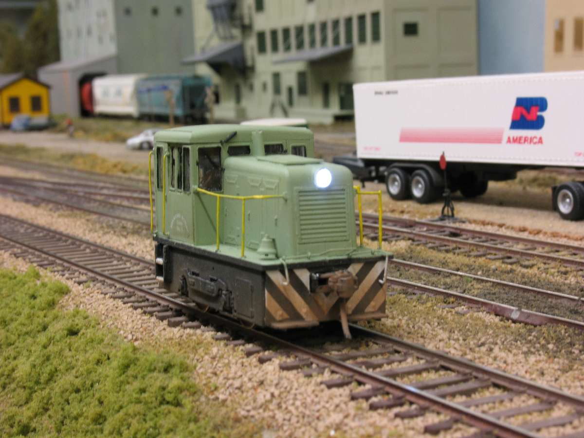

Some time ago I’ve scratch build a 25-ton. This gave me the idea how to change the Grandt Line kit to get a good runner. Here’s my HowTo
Wolfgang
Wolfgang

For those of us who have a Grandt Line unbuilt kit or built kits we would like to upgrade, could you provide the details of the Bull Ant mechanism: Model number, gear ratio, etc that you used, so some of us could upgrade our model.
I have the kit I am planning to use to model a cement plant switcher. Would love to end up with a smooth running DCC sound unit like yours.
Many thanks!
Chuck
I’ve ordered Motor Bogie BullAnt
one 2 Axle BullAnt
16.5mm Gauge, 1015 Motor
Wheelbase: 21.4mm, 60:1 Gears
Wheels: 9,6mm 110 disc
Later I’ve exchanged this with same type but silent drive with highest ratio!
Decoder is LokSound micro together with the speaker.

The Grandt Line diesel is shown as a powered model. Is the stock drive a poor runner?
With the original drive it did run, but very jerky and only fast. Maybe I’ve built it not correct. I wanted to know and proof what I’ve heard. And the pulling force is low. With grade no cars!
Wolfgang
