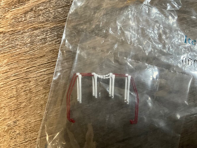

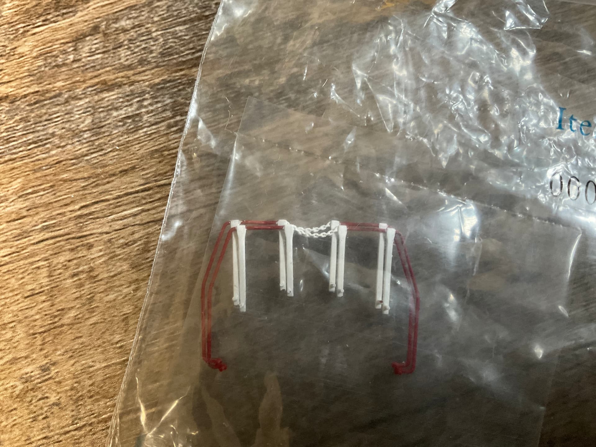

I have this locomotive that came with just about everything built/attached except the front and rear handrails. They are in a small bag and appear quite fragile.
My question… should use glue when I place them in the proper holes

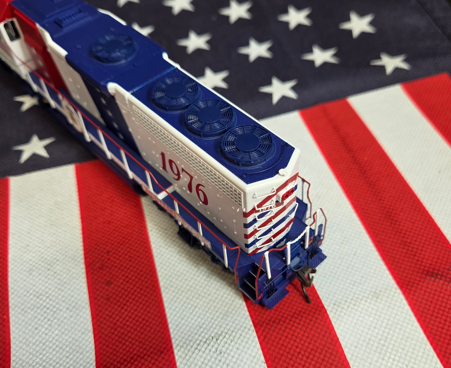

I already put the sunshades on (not shown in this pic)

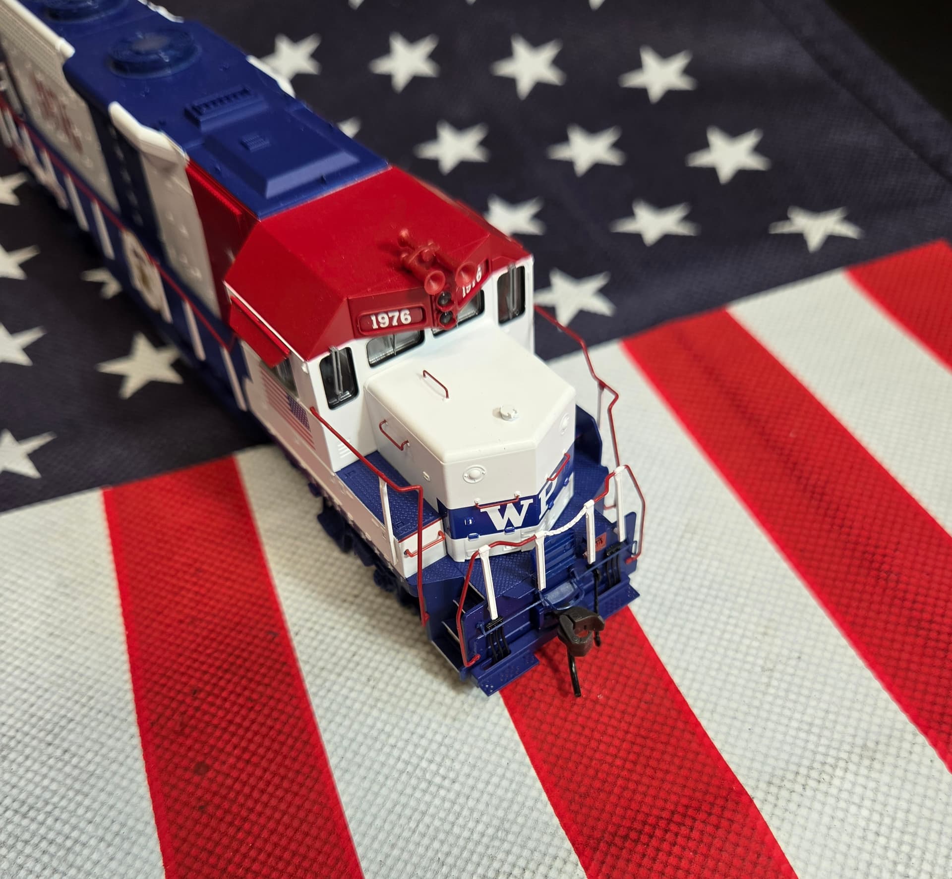

If the handrails fit firmly in place I would not glue them. Using glue would be the last resort.
My two cents, Cheers, the Bear. :slightly_smiling_face:
Thank you
I agree with the Bear. Usually they press fit snug enough without requiring glue, whether intentionally by the manufacturer or not. See how it goes, you can always then glue them if necessary.
Regards, Chris
If you need to use something to hold them in use a clear silicone that way it can be removed and not hurt the plastic.
Excellent idea… had not thought of that. Thank you.
A forgiving, yet strong glue of many uses is Canopy Cement, gets tacky quick and dries clear and flexible, but with a long full cure time. Small amounts of errant cement caught while still tacky can be carefully removed with the tip of a toothpick and or tweezers. Regards, Peter
100% what I would do… a dab of clear silicon applied with a toothpick. That way, if the loco/car is handled too roughly (or dropped), the part will pop off, instead of breaking off. Much easier to repair.

Worked well… no glue or clear caulk required
Thanks everyone
