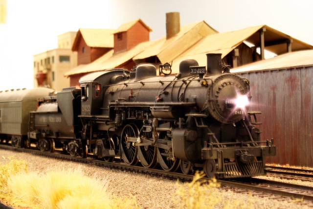

Here is a shot of a Surface Mount LED in a brass loco headlight mounting. Looks great when it is on, looks like someone stuffed a tiny box of kleenex in the loco head light when it is off. Needs a lens…
