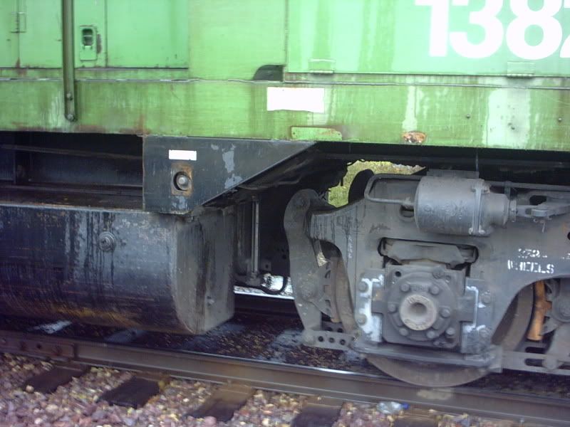

I hope these help with the Torpedo Tube GPs. Had one come in to Horicon for paint a while ago. Steam gen long gone, but most of the rest of the stuff was there. Ex-NP unit, but most should be similar.
The tank between the trucks is actually three separate tanks. Two visible from the outside, and one hidden down the middle.

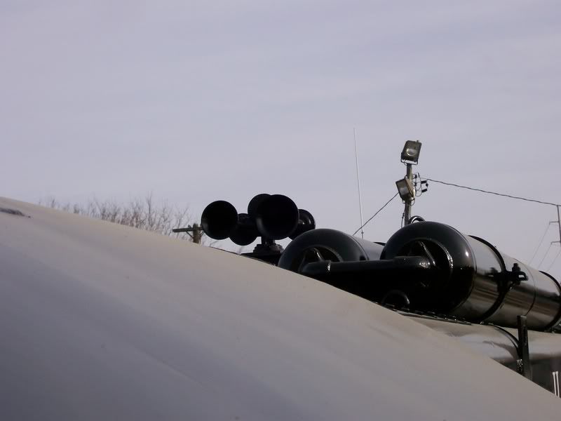

These bigger tanks forced the air reservoirs to the roof.
Here are the best shots of the rooftop piping I could get.

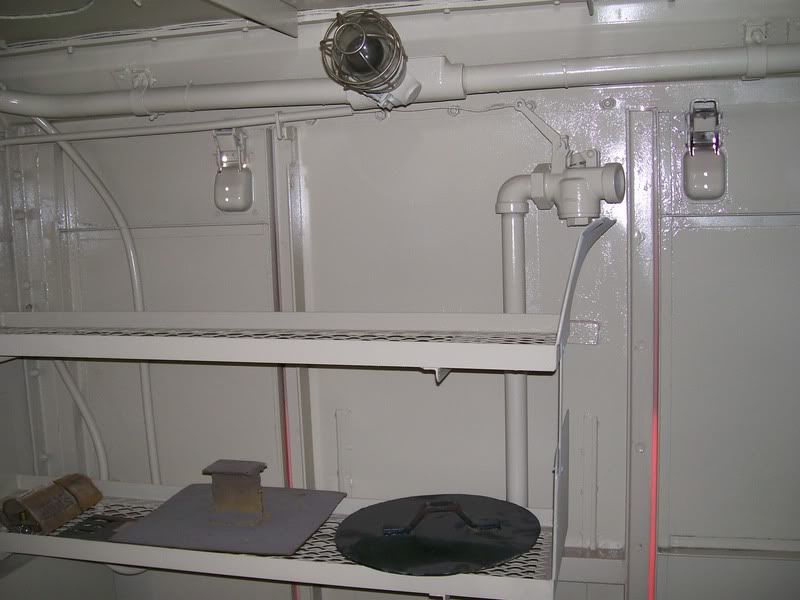

Unit still had high short nose. Lots of room in there now.
The steam generator would have been in there.
