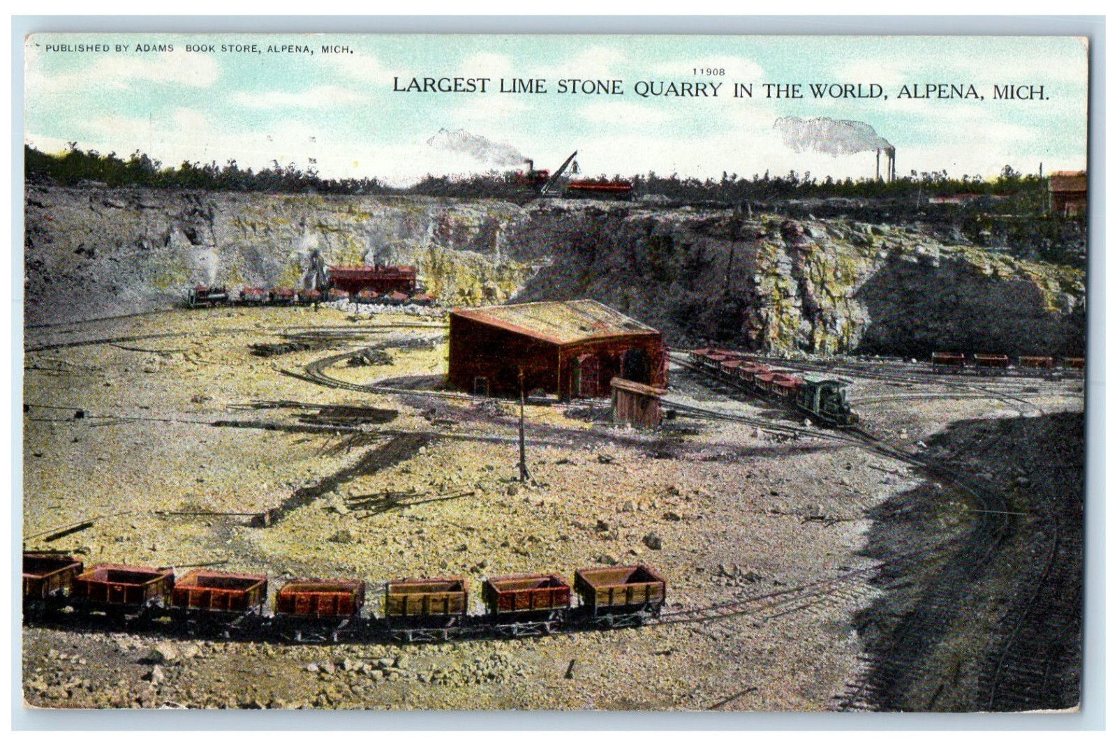

Serving rock quarries. Just to be clear, there is the question of how is stone shunted within the quarry itself…and how did the railroad serve the quarry with interchange type of cars.
I think simple shunting took place with cars that look like small ore jennies…MDC/Roundhouse/Athearn types.
These pics are from the public domain, and are probably earlier than transition era:
stone quarry For Sale - MAVIN
For interchange types of cars, my understanding is that specialty cars were less common during transition era than they are now, so I would feel comfortable using 40 foot low gondolas or open hoppers filled to lower capacity due to stone being heavier than coal.
