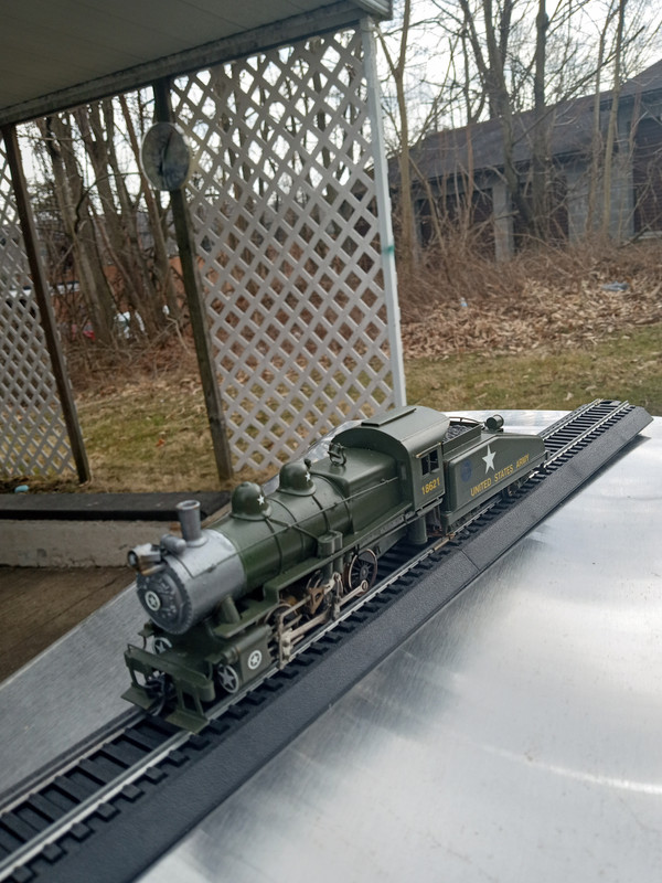

I use Tamiya Gun Metal Gray.
Thanks for responding, Philo. That’s grimy black? In that photo it looks to me more like a squeaky-clean green!

They are two different locomotives!The 0-6-0 is indeed Army Green and the Bowser 4-6-0 was painted Floquil Grimy Black when I built the kit in 1986.

Well, paint me Embarrassed Red! So they are. Actually, if the color on the Bowser is grimy black, I like it a lot.
