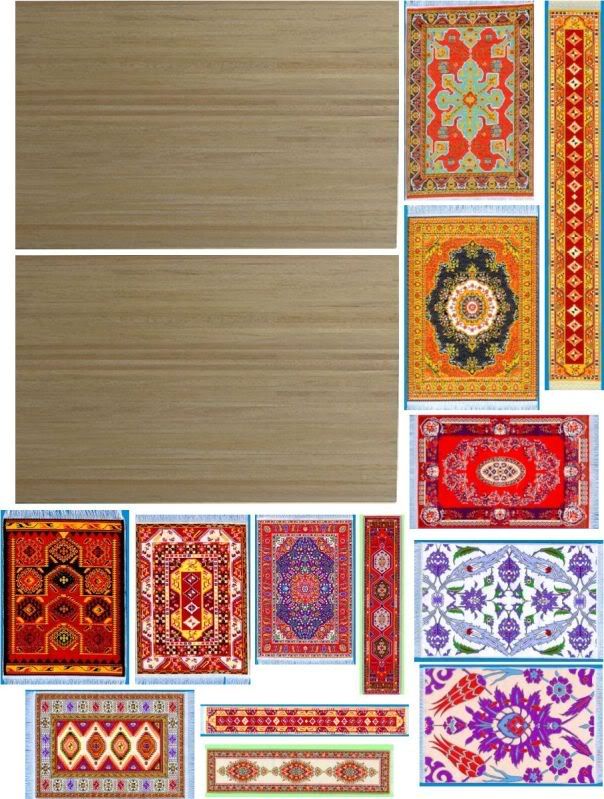

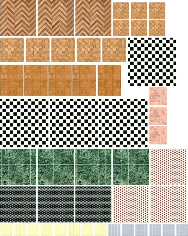

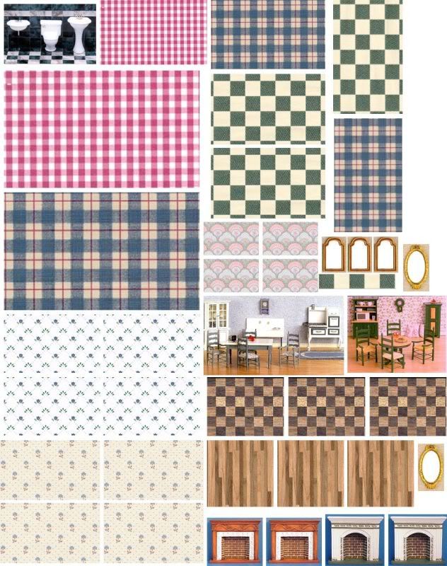

You can print hardwood floor on paper or slightly thicker cardstock on your computer. That’s how I did this freight house:
I get floor and wall textures from
http://www.textures.com/
These are designed so that you can place them end-to-end and top-to-bottom and they form a smooth, continuous pattern. I download them and then import them to Microsoft Word, which lets me position and size them before printing.
After I print them, I cut them to size and shape and then glue them in with Aileen’s Tacky Glue, a craft store product. I like Aileens, particularly on cardstock, because it is thick and will not bleed through from the back and spoil the image on the front.
You can print the same textures on decal paper if you’d like (www.decalpaper.com) but they’re much more difficult to apply, and it’s harder to get the color balance right.
