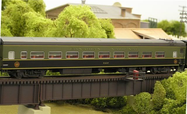

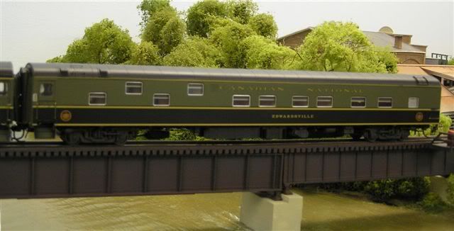

My good friend who models the CNR got some of the Rapido cars when they were first released, and wanted them “lightly weathered”, much like I do most of his locomotives.
I used Floquil, thinned with about 90% lacquer thinner, and simply placed the cars on a length of track (old Bowser turntable bridge) in the paint booth, then rolled them back-and-forth as I sprayed, aiming only at the trucks and underbody. Naturally, a little got onto the cars’ sides, too, exactly as it should have.
Keeping them moving ensures that the wheel faces get consistent coverage. I don’t recall for sure, but I likely used at least two or three colours - I usually have 8-12 thinned weathering colours available at any time, but not all are appropriate for all cars. All are mixed from left-overs from previous paint jobs, and are usually altered somewhat every time I paint.
