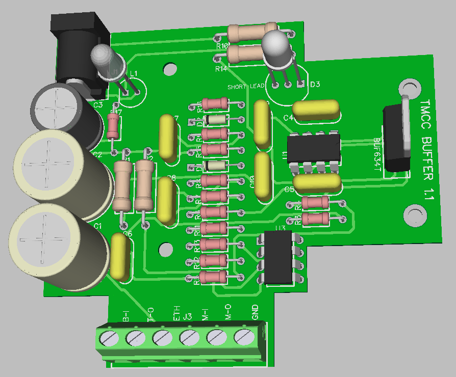

For the sizes of PCB’s I typically do, I can get PCB’s for peanuts. It takes a couple weeks to get them, but I recently ordered ten of these from https://www.seeedstudio.com/ and the total with shipping was $11, the board is roughly 3" x 3". Trying to kludge something like this with a 3D printer just doesn’t make much sense to me. By the time you sit down and carefully drill all the holes, etc., not to mention the dealing with the via’s, I just don’t see the point.
