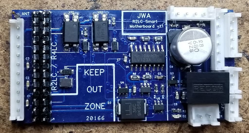

Here’s a typical board that I would create, I can’t imagine being able to do this with my 3D printer and getting a usable result.
