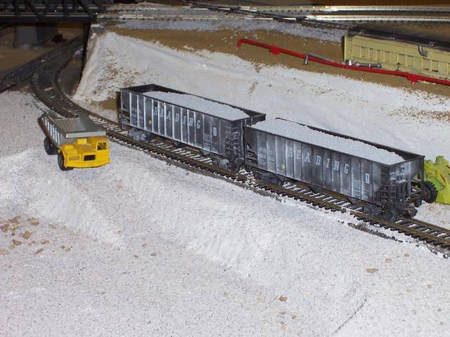

This is an open pit mine built by my friend, Al Mosier.
