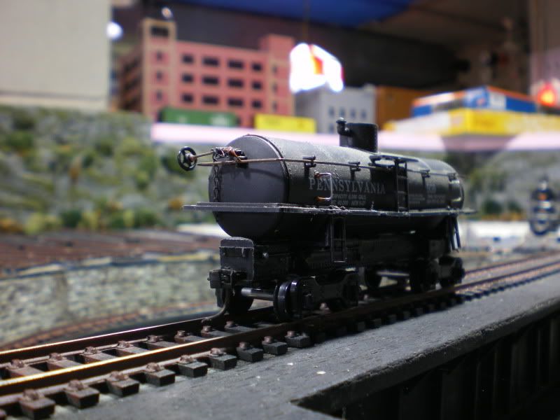

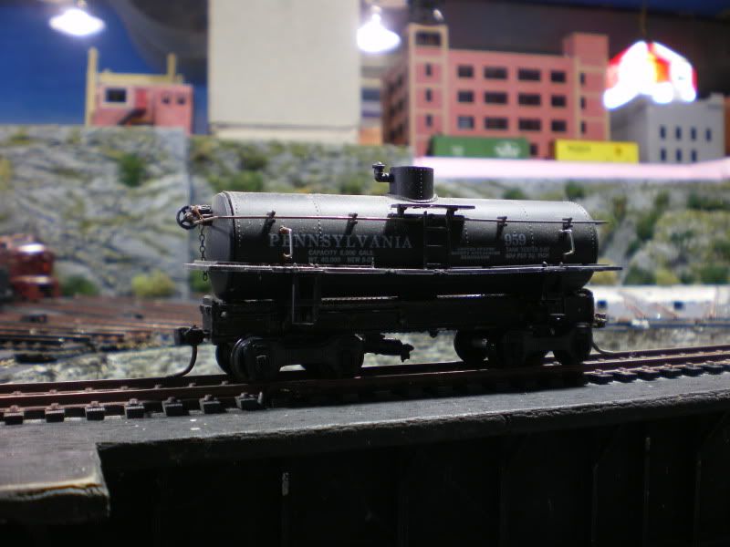

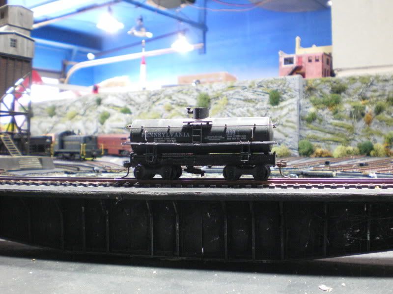

Have not found prototype pictures yet but here is a picture of my HO, PRR tank car.
Doc
