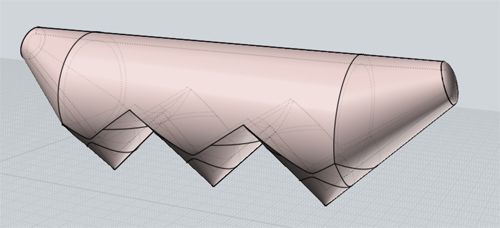

You mean like this?
It’s going to be a while before I can get this uploaded to Shapeways. I’m working on it a bit at a time. There’s a lot of detail to it that’s time consuming. I’ve never uploades anything to Shapeways before so I have no idea what the cost will be.
I’m designing the main tank to be a separate piece with no details so that you can sand it smooth if needed.

I’ve been working on the frame. I got a bit concerned when I stopped by Shapeways and saw that they recommend a minimum thickness of 2mm for all parts. A lot of the parts on this will be small than this. But there’s an N scale dry bulk truck there that has some pretty small parts, so an HO scale one should be okay.
ETA: I just saw over at Shapeways that Frosted Ultra Detail can go as thin as 0.3 to 0.5 mm for non-structural parts. So the 2mm value must be for another material.

Made a lot of progress last night and today. The model is nearly done. It would have gone even faster, but a few parts I had to rebuild several times for various reasons. I hope the ladder isn’t too delicate. The tire even has a tread pattern.
I plan to lay the parts out connected by a sprue, the way a plastic kit would be. The sprue will add to the cost but it should be a lot easier to paint things when they’re separate pieces, rather than having the entire model printed intact.

I’ll be putting it up for sale at Shapeways.com. It’s a 3D printing service. This all assumes the result is up to snuff. Someone’s got an N scale bulk trailer at Shapeways and it looks pretty good, so an HO scale version should look even better. In case the finish is a little rough, I’m making the tank as a separate piece with no details on it so that you can give it a good sanding and priming without ruining any detail. The hatches and handrails will be separate objects to be added after.
I have no idea what the price will be because Shapeways sets a minimum price to cover their costs based on the amount of material used. The seller than adds some profit to that. I’m not going to be adding much. I’m not looking to get rich off this, just make a little something

Here’s a rendering of what it will hopefully look like. I left off the mud flaps because they would have to be too thick. I figure you could use something like the plastic from a sandwich bag. Spray it black and cut out a little rectangle.
