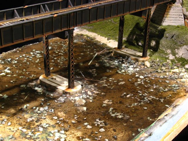

Sleeper, I used a product made by Swing Paints, called Nu-Lustre 55. I am fairly certain it is a typical two-part epoxy comprising resin and hardener that are to be mixed thoroughly in equal measure. It dries nice and clear. I haven’t priced Envirotex, but if you do and then inquire over the phone from your local hardware store, they should carry epoxy in their paints and finishes section. You may save shipping costs at the least, and maybe more.
Just a caution…don’t take shortcuts. Read the instructions and follow them to the T. I did with the Nu-Lustre and was gratified with excellent results. Measure each liquid carefully, combine them, mix for at least two full minutes without trying to whip it (deliberate mixing at slowish speed), decant into a second clean vessel, and then stir for another two full minutes. Pour slowly over a fairly wide area, spread with a disposable spatula to get it to the corners without actually painting (just get it mostly there), and then wait 5-10 minutes for it to spread and settle. You will probably find tiny bubbles throughout. No worries. Take a soda straw and blow gently on the surface using the soda straw. Amazingly, all the bubbles disappear like magic.
Here is what it looks like when hardened. Now 16 months old.
