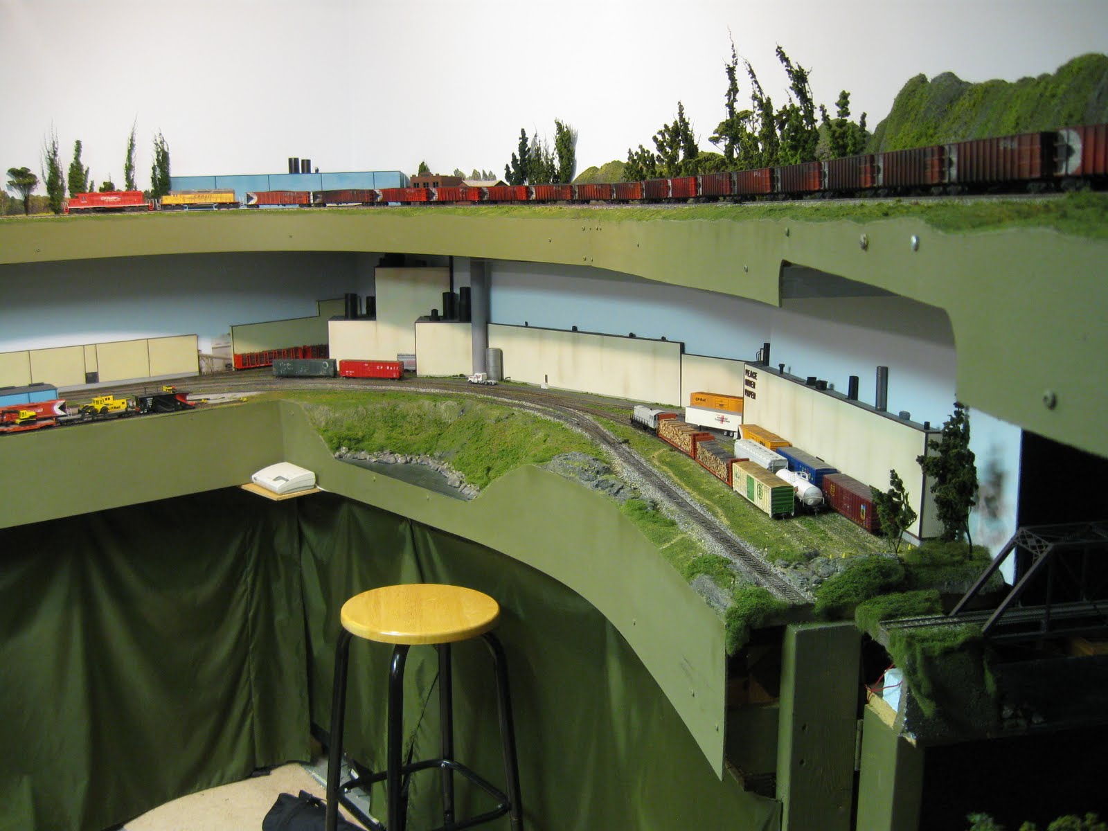

A photo of the Peace River paper mill on my layout. Box cars, covered hoppers, pulpwood and tank cars in, box cars of paper out. All the piping and other hard-to-model stuff (for me) is behind the flats.
http://cprailmmsub.blogspot.ca/2010/09/peace-river-paper-mill.html
John Longhurst, Winnipeg
