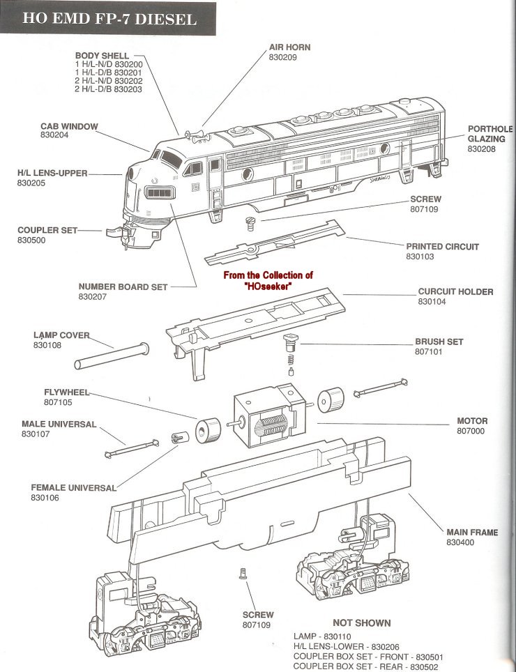

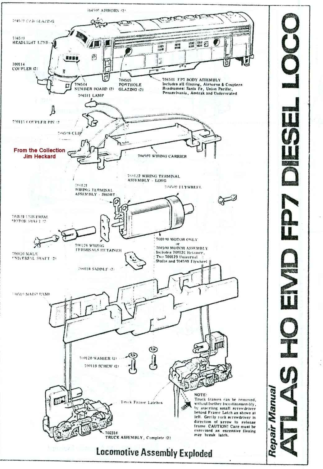

I thought that Roco was in Austria. If that engine was made around 1975, does it look like: http://hoseeker.org/assemblyexplosionAtlas/atlasemdfp7diagram1975.jpg ?
The other FP7 diagram I can find looks like: http://hoseeker.org/assemblyexplosionAtlas/Assembly%20Explosion%20Atlas%20FP7.jpg . The truck asemblies look very similar.
The hoseeker site shows the FP7 truck assembly http://hoseeker.org/assemblyexplosionAtlas/Assembly%20Explosions%20Atlas%20EMD%20FP-7%20Truck.jpg and this drawing suggests that the truck was made in Austria. The Atlas website has this same diagram and I think most of the parts are available (if the website is to be believed).
Obviously you have the engine in front of you so maybe you have something different from the diagrams. However, if the engine does look like the diagrams I’d go back to Atlas and re-ask the question. If you asked them the first time if they had parts for an old Roco-made engine, you might have got an inexperienced individual who might not have been familiar with what they have. If you can tell from the engine that you have what is shown on the diagrams, then you can ask Atlas if they have the parts by the proper part number.

Thats the truck I need all right. I did call Atlas but they
Looks like Atlas almost has enough individual parts to build the thing, except for the worm assembly, the bearing, and the wheelsets. Too bad that close enough is only good with hand grenades and atom bombs.
