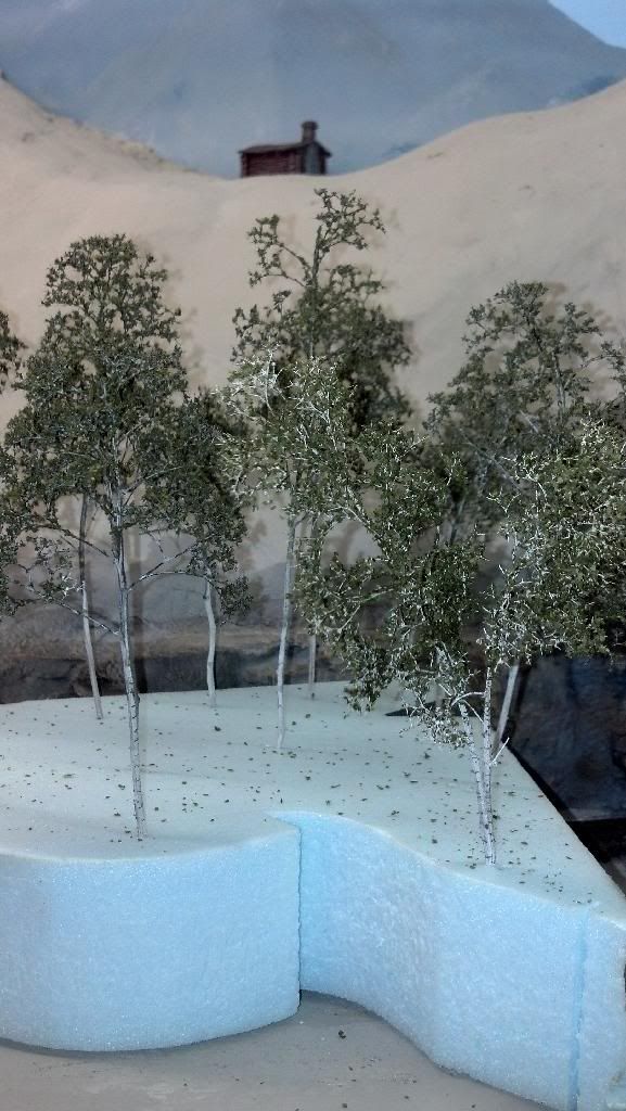

I appreciate everyone’s input. Below is a photo of my first attempt. I think they came out pretty good. I used SuperTrees armatures. You have to select the right ones–they are the left-overs that you wouldn’t want to use for deciduous trees. I spray painted them with a cheap, flat white rattle can. I then stained them in an india ink wash. I used Scenic Cement to hold the foliage in place and made the telltale black hashing on the bark with a very sharp black colored pencil (the ones in the foreground have this done, not all of the ones in the background have been “hashed” yet). Remember, these are N scale, so the photo is actually larger than actual size. Thanks for all your tips.

I like your trees, I actually have some birch tree armatures that were a gift, but they are like winter, no leaves. So I need to try your polyfil process to build a canopy on them
Ron, I think you did a great job, your white birch tree’s look great. How did you do hte leaves/canopy?
Aflyer
I agree. They look very good!
The foliage was easy. I just dipped the top of the armature in a small bowl of Woodland Scenics Scenic Cement then sprinkled it with healthy covering of Silfor Birch Tree Lite Summer folliage straight from the shaker and stuck in in a piece of foam to let it dry.
