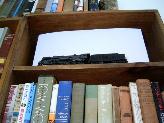

Here’s an unpainted static model that I set on a shelf at 6’-10 1/2" with some cardboard 4" behind it.
The photo was taken with the camera at my eye-level. (I’m 5’-9") If having a layout meant putting it at this height, I would live with the limitation.
Alternative locations almost certainly would be preferable but jflessne didn’t ask for alternatives or indicate aternatives were possible, so I saw no need to second-guess him and simply tried to offer some positive suggestions for his scenario instead.
If building a layout in unusual places means having a layout of some kind vs having nothing, I would always opt to encourage building it despite the obstacles.

Thanks for the picture. It shows exactly why I wouldn’t do it. But, It is not for my railroad, so jflesnee can do whatever suits his fancy. Personally, I’d like to see the trains better for all the effort he’s going to have to go through.
