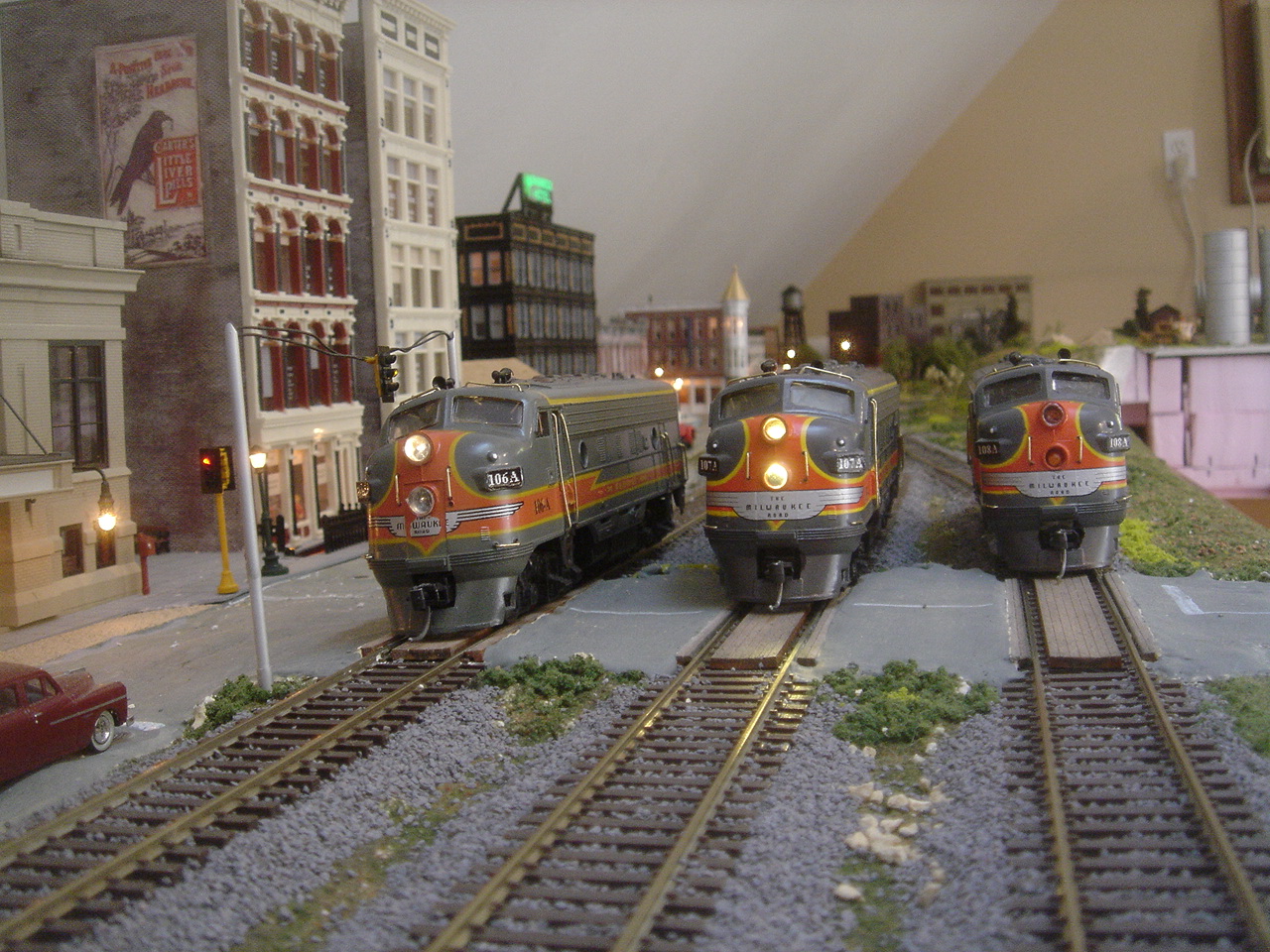

Hopefully this one will go out to the whole group to see. Bare with me, I am new to the forum. To everyone that gave suggestions, thank you! The posts are all helpful. I attempted to use hydrocal but my milk carton of it was well expired. I live in rural northern VT so going to the local hobby store is out of the question. I made a sample tonight using durabond 20 minute set. Kinda like plaster of paris, but more like variable joint compound. Came out well, a bit messy, but I think this is the ticket. I was looking for good samples via MR, and you all came through for me, much appreciated.
Pete
