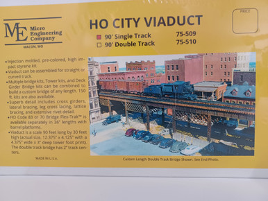

If you have the time (and money) you could kitbash an EL track structure using Micro Engineering steel viaduct kits:
Regards, Ed
The double track version doesn’t look too bad.
