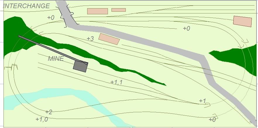

you could look at any trackplan. Making it larger is always possible. However the catch is accessibility. Anything further then 2 feet from the edge is hard to reach.
The combination of depth and height of a layout has been filling loads of threads on here. You should be able to uncouple cars and reach them in case of an derailment; and for maintenance as well. Imagine yourself reaching over fragile scenery to work on a track 30" away from you. Building a layout on narrow 16 " wide shelves has advantages.
Any trackplan, every 8x4 could be made larger without reach in problems if you accept a central operating pit. A donut style layout in stead of an island type.
An island type needs access to three sides, the roomspace neededis 10x8 at least:
A donut style layout: no access space around the layout is needed:
