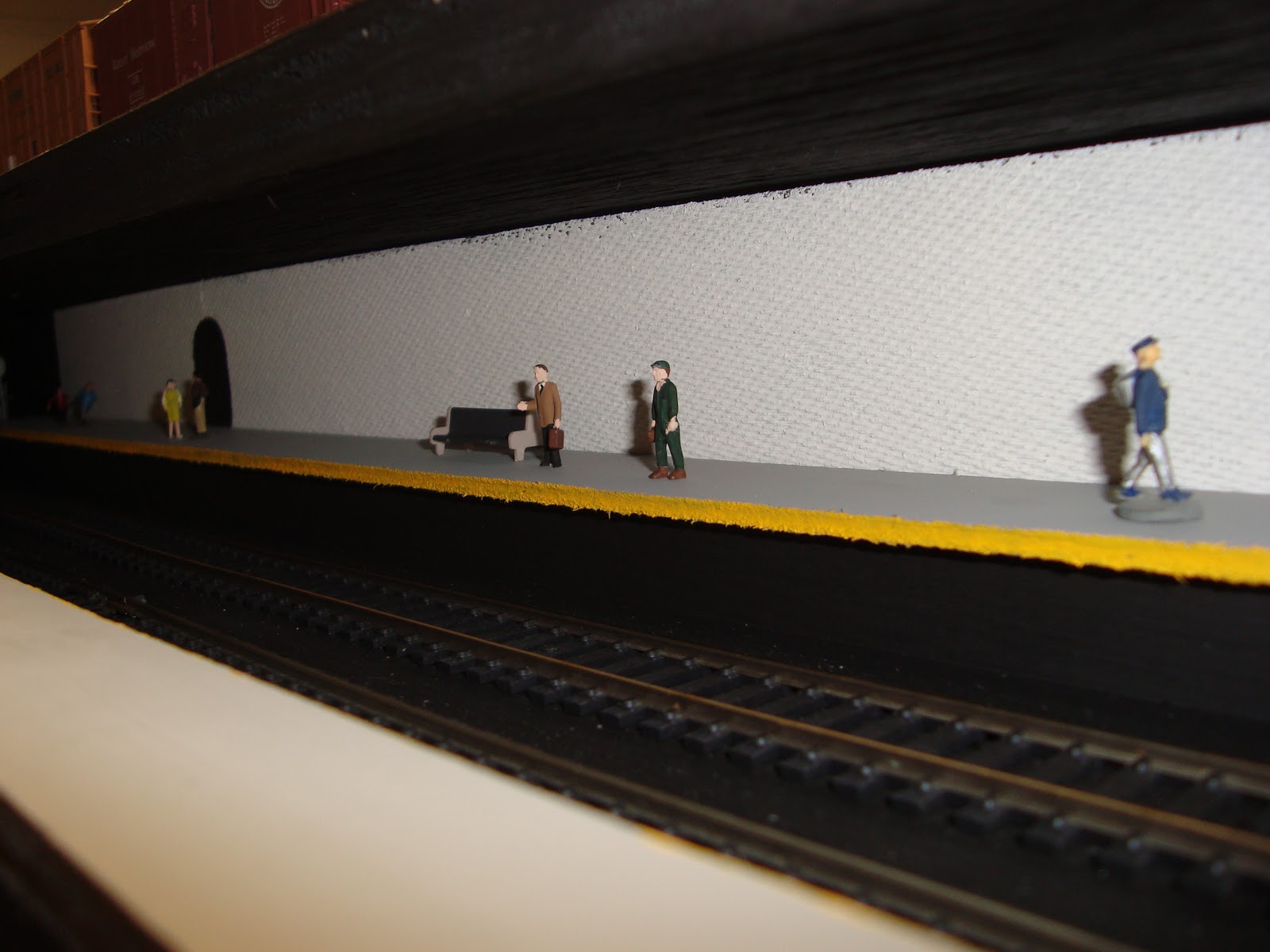

Here are some pic’s of my station. I just printed stuff out on the printer.
