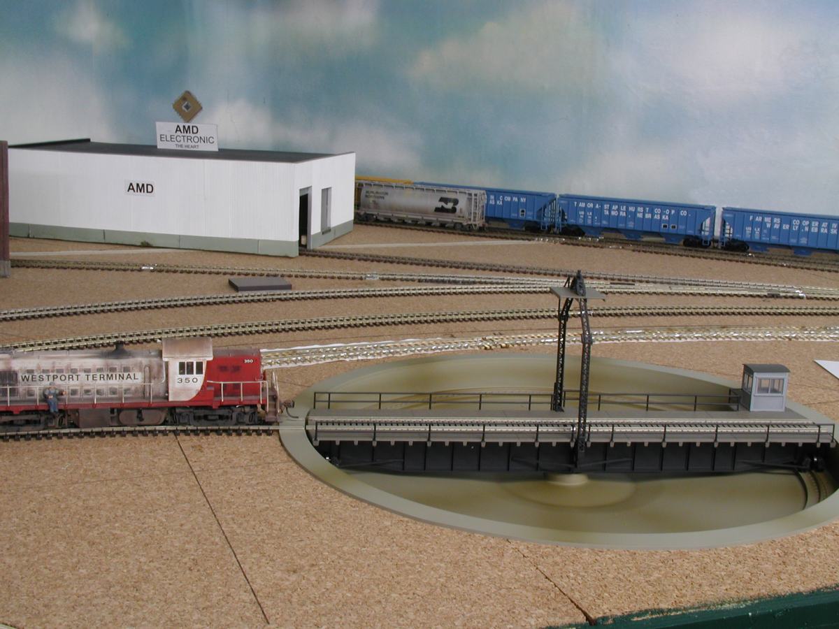

I’m happy with my Walther’s:

As far as the best bang for your buck the Walthers built up turntable is the best buy out there. I have the 130’ version on my layout and have installed both the 130’ and 90’ on our club layout. Understand that even is you find a Diamond Scale Turntable at a really cheap price they are nothing but junk. I have known guys who have given them away because they are such a nightmare. They were the standard back in the day because no one else came close to making anything that was close to theirs in respect to details etc. The indexing system is caveman technology and is totally unreliable. Not having any affiliation with Walthers or trying to sound like a cheerleader but you open the box drop it in the hole after you cut it out via the provided template hook up four wires and your done. It will take you longer to program the indexing portion then the actual install. I believe the new versions are even dcc programmable so thats a huge bonus.
The Walthers unit even though it’s a little pricey can be had for a good price if you shop around. Back when you couldn’t get one form Walthers I paid $230 from a local train store that just opened up. When I asked him if the price was some sort of promo deal he said no my everyday price. I am pretty sure if you buy one you’ll be happy with it.
