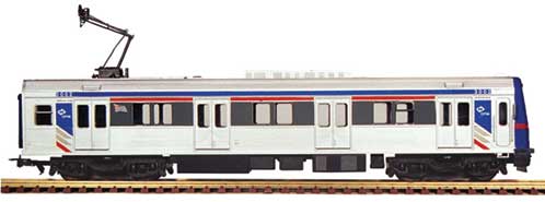

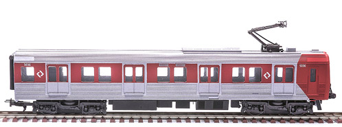

The R32 cars are too dated for my layout. And the Brazilian cars don’t seem to be available in the US.
But I understand that HO and OO is close enough for my needs since the subway won’t be running alongside my mainline.
