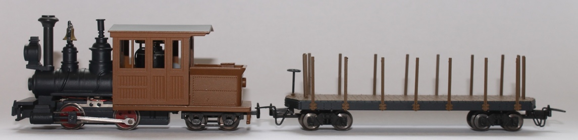

For those of us, who are not able or willing to invest the gold of Fort Knox into a train set, there is Minitrains, who offers a nice variety of little engines and cars, some following US prototype.
Minitrains
Aside from their Fiddletown & Copperopolis inspired 0-4-0 loco, they have announced a 0-4-4 Forney loco, which has a lot of character.
Minitrains locos are said to be good performers.

Regarding the HOn30 Minitrains: At the October Great Scale Model Train Show in Maryland, there were two small display layouts operating these models. They appeared to run quite well, with continuous running for the hours that I was at the show.
I had the early Minitrains back in the late 1960’s and they had two speeds - off and REALLY fast. I have purchased the new ones but have only tested them with jumper cables to a section of the Peco track. They operate reasonably well. For now, these new ones rest in a box of accumulating items that, hopefully, one day will become a micro-layout with an industrial setting.
Bill
Like the old egger-Bahn stock, early Minitrains locos were quite doubtful performers. They had nothing in common with the “new” Minitrains locos, which sport a can motor equipped with a flywheel.
