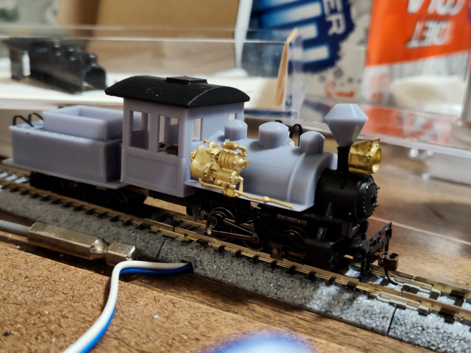

This is going to be a project log for my HOn30 0-6-0 steam locomotive. It uses a bachmann n scale 0-6-0 as a base, the major components come from a 3D printer on ebay, and I’m using brass castings to superdetail it.
Here’s the progress I’ve made so far after a weekend (about 5 hours of work in total, not counting waiting for stuff to dry or cure)
You may note it has a saddle tank and a tender - this is inspired by a Canadian Collieries Locomotive that started life as a saddle tank locomotive, was given a tender, but never lost the saddle tank. The railroad I am freelancing is a mining and logging short line in the Copper Country of Michigan, and as a result I want to give it some of that backwoods weirdness - that’s also why I am using this HOn30 to represent 2 1/2 gauge instead of 2’ gauge, since there were some weird gauges up in the region (4’ 3 1/2" narrow gauge is one example!)

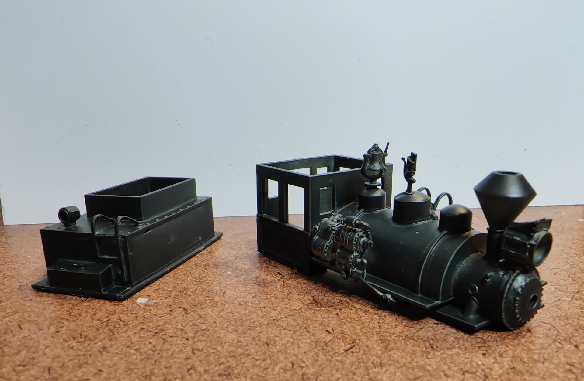

Just a quick update for today, got the bell and whistle installed, some piping bent into place, and primed and base coated. I’m planning on painting the nunber plate separately.
Need to decide how I want to do the wood for the cab - I am a fan of the heavily worn look on narrow gauge steamers - though I know they’d seldom get into that bad of shape during their lifetimes.

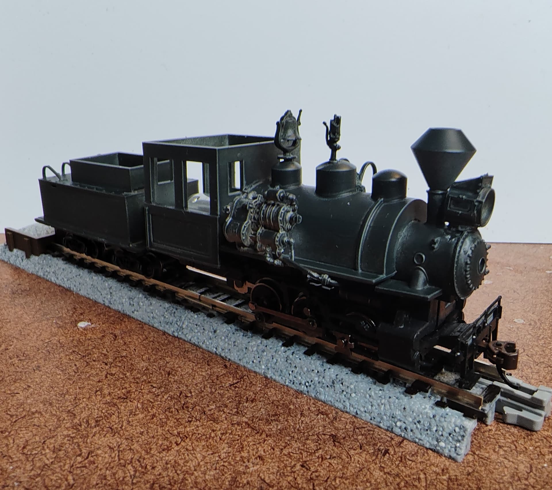

and a photo on her chassis since I uploaded it to the other thread.
