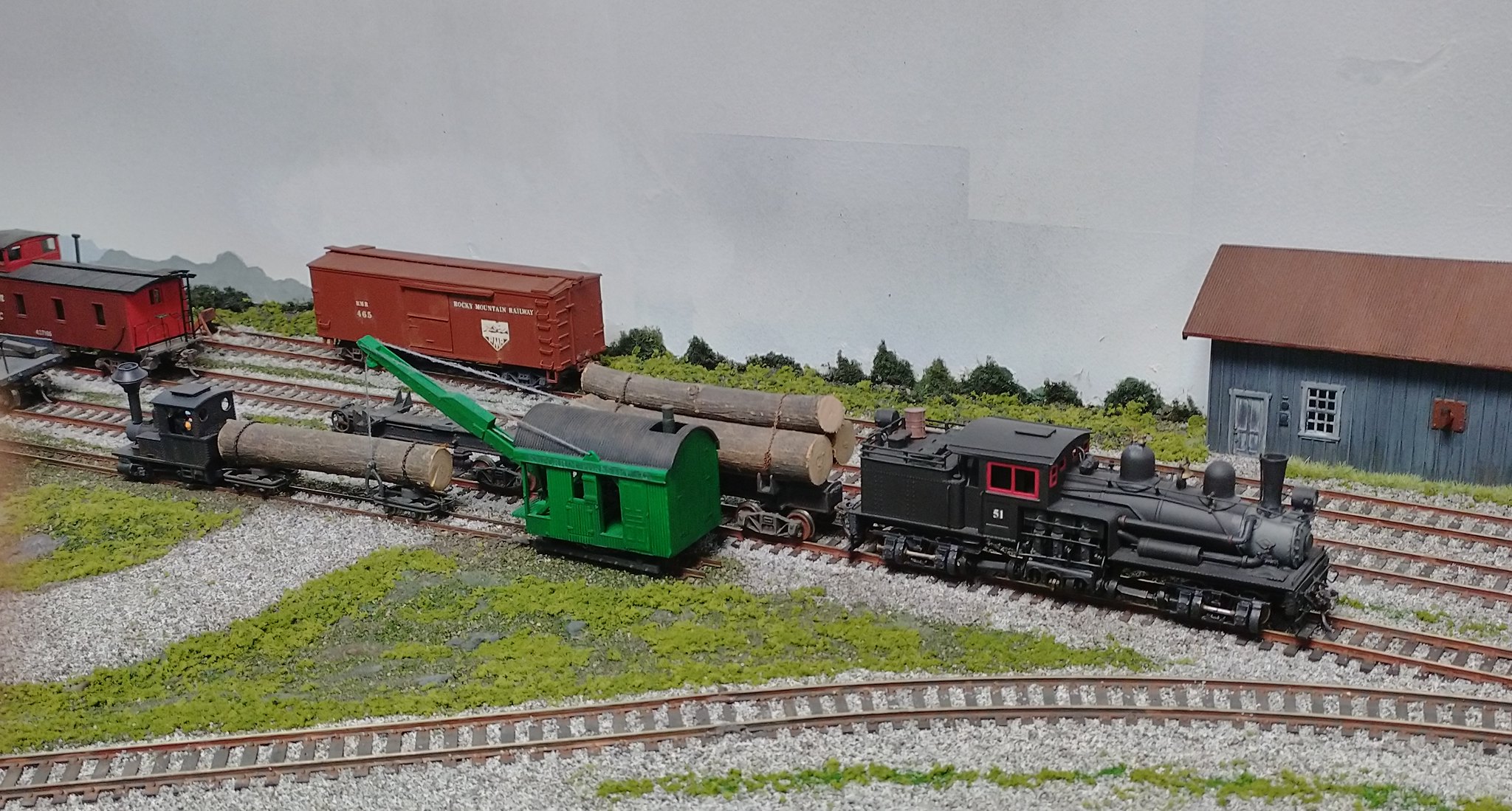

There were passenger and industrial usages. One of my favorites is the Gilpin railroad, that had nice Shays. I have two short lines on my pike, one serving a quarry, the other serving a sawmill (loco on the left):
IMG_20211203_213915 , on Flickr
