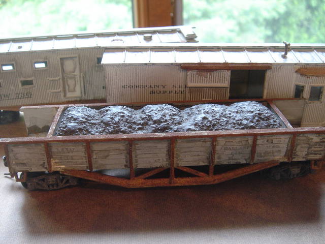

This may be an opportunity for weathering. “Instant Rust” could be used to cover up whatever damage the glue did to the model’s surface.
This MOW car has seen better days:
