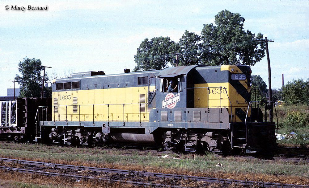

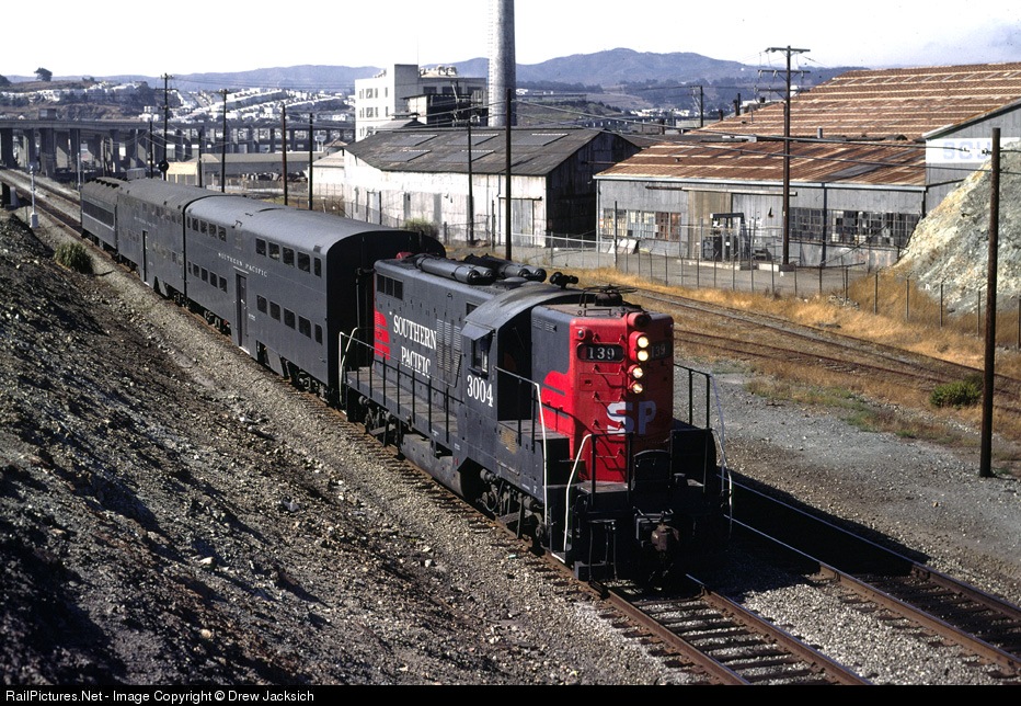

OK, the GP97 (1500 HP 567B engine) introduced in 1949 after the BL2 failure, was EMD’s first road switcher (OK, the NW3, NW4 and NW5 were light roadswitchers). It can be identified by three sets of louvers on the battery box under the cab and two sets under the radiator. Variations - Dynamic Brakes (after 1950), Steam Generators, Water Tanks beneath frame (with air tanks on to of the hood), 36 inch dyanic brake fans (until August 1952) then 48 inch, Sloped Pilots (until mid-1952), then flat with boxes for MU hoses, Some early units lacked the box-step on the walkway on the left side of the cab, Controls - short end front, long end front, bi-directional. Head End Power in squared off long hood. 5 B-units for the Santa Fe. CNJ 1524 is HEP equipped
“Torpedo Boat” with roof mounted air tanks
GP9’s (1750 HP 567C engine) were introduced in 1954. Spotting features are - Single Louver, later 2 small sets on battery box, Louvers on the first two large hood doors behind the cab, a third was added later, Small Louvers under the radiator. Fuel Tank Skirting perforated on early units, cut down on later (often done by the owner to early units) Options - Dynamic Brakes with 48 inch fan, After October 1957, the 4 36 inch roof top fans were replaced by 2 48 inch ones, Steam Generators were an option, Enlarged water tanks with air tanks on the hood roof a seperate option, Fuel tank size varied as per customer request, Low Nose option was available late in the production run, with an SP order for 20 being EMD’s first low nose locomotives, Controls as per GP7. PRR(40) an
