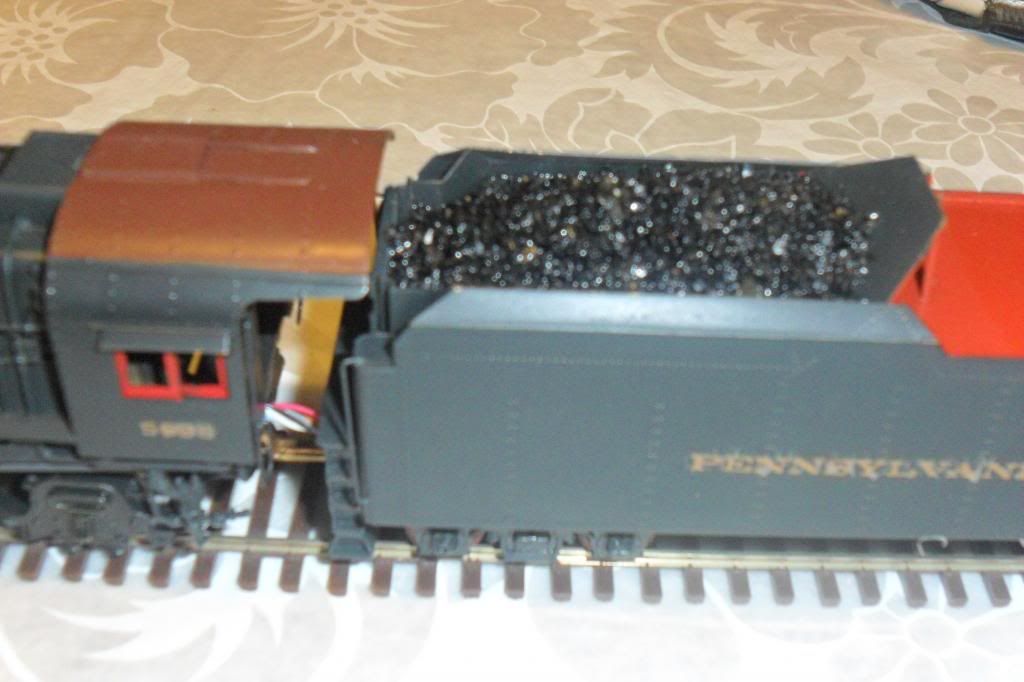

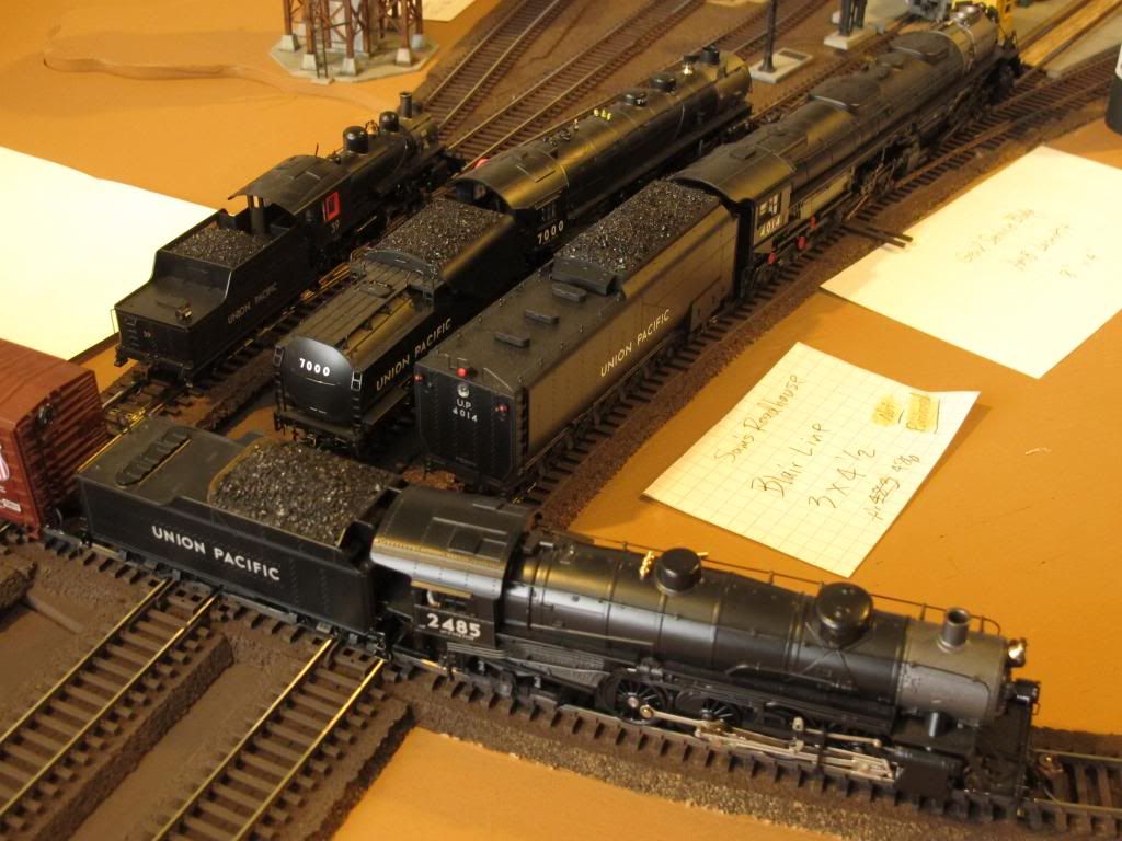

I use black beauty sand blasting media for my coal loads. White glue and water mix like ballasting works good. For my brass locos such as this K5s pacific the media is glued to a foam block.
It looks shiny because it was still wet when these shots were taken.
Pete

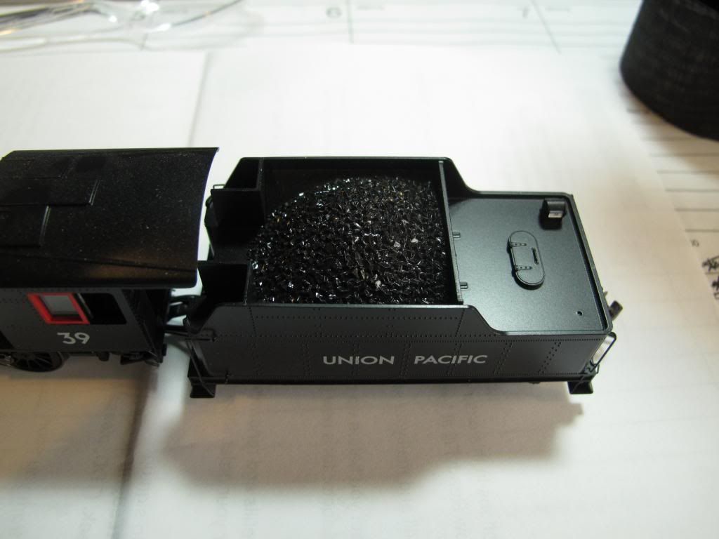

For my brass loco coal loads I use either a carved foam or balsa block, paint it flat black and then use straight-from-the-bottle Elmer’s white glue. I then sprinkle on scale coal to cover and let dry. For the plastic locos with the molded coal, I just coat the mold with Elmers and follow through with the same application.

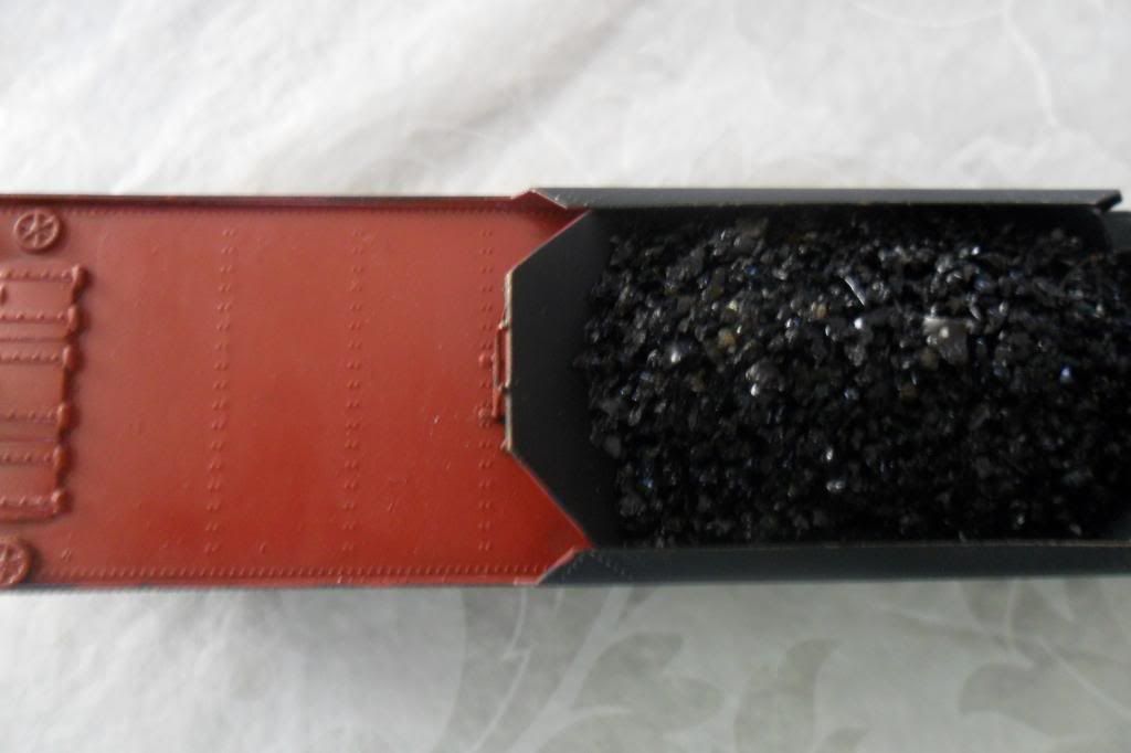

As a followup, thought I’d post a couple of photos after adding the Arizona Rock & Mineral medium coal to the loads in a Bachmann mogul, BLI mikado and mountain, and Athearn big boy. The mogul photo is the “before” for the mogul, which was the best plastic representation (for me the worst was the dull big boy load). The photos don’t do justice to the difference. I’m quite happy with the result. Used slightly diluted white glue, a layer of coal, then 50% diluted glue w/dishsoap and dusted a bit more on. Then turned it over and let the excess fall off. Thanks again for suggestions.
